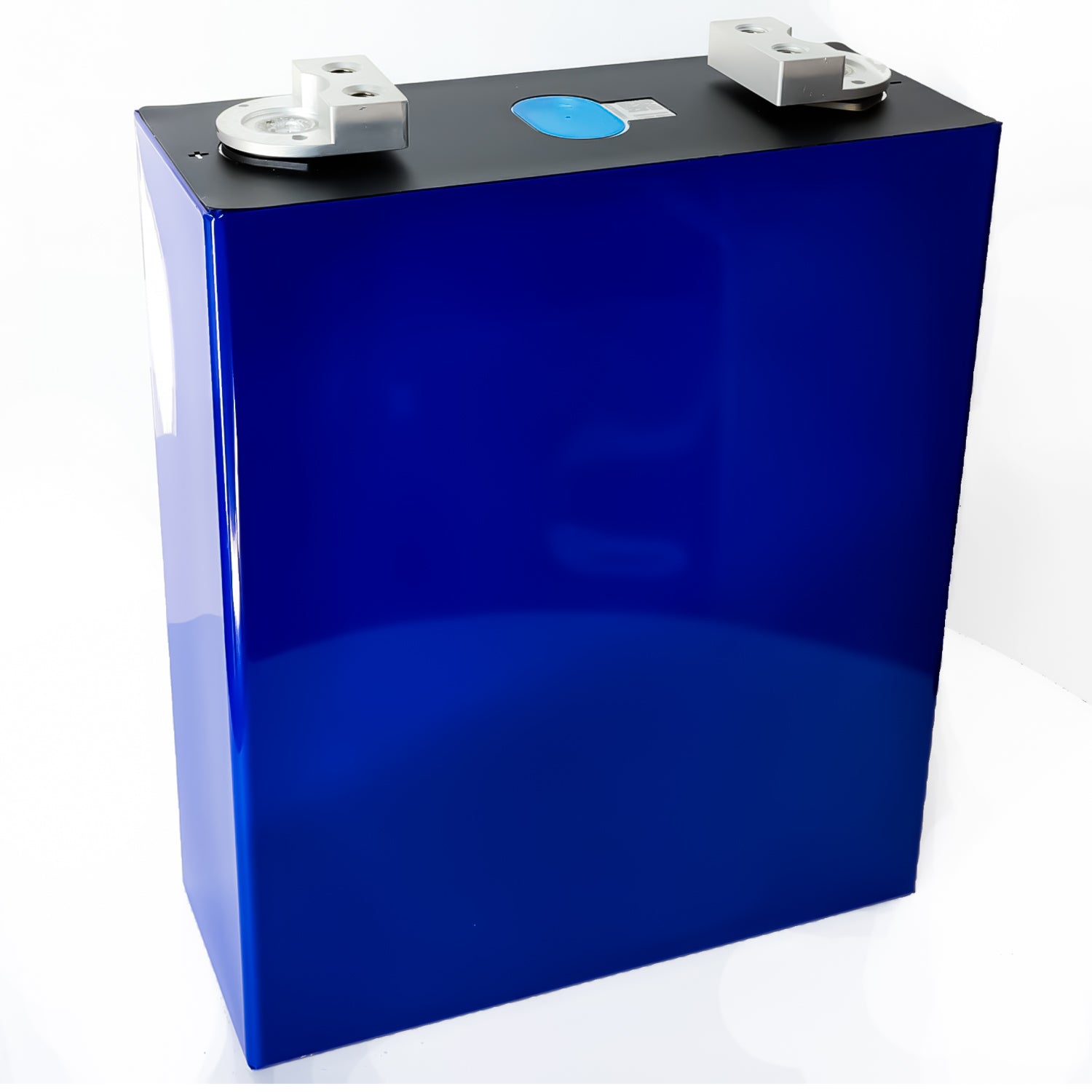

So, I bought these:
Described as
32 Pack ExpertPower 3.2V 304Ah LiFePO4 Lithium Battery Cell | UL2580 A+ Grade 4000-7000 Cycles & 10-Year LifeSpan | Deep Cycle Rechargeable & EV Grade | Home, Cabin, Off-Grid, Solar, Golf Cart, ATV​
Not knowing to look further I saw Grade A and bought them. Between Amazon points and getting I think it's 5% back on the account I pay from, seemed like effectively 10% off one way or another. Is that 9.5 cents per wH ? And does anyone know what the odds are I get a bad cell or three? Or are they all iffy?
I'd love feedback here before they ship.

Chances are they are exactly what they claim to be. Expertpower is a company that primarily targets the RV market by reselling items others build.
You paid $92 a cell which is a fair price, but with free shipping it seems fair. Most others sell them with bus bars and bolts packaged in the box which may account for some
Don't be folded by the marketing, they just inventory and ship stuff without testing or even looking in the boxes.

So they are probably no worse than run of the mill for "Grade A", and Iikely buy accessories another time. Thank you!

Be VERY wary when torquing the bolts down on these.
DO NOT put any downward force on the bolts as you are torquing them.
The odd angle the terminals were welded to the lugs are fragile to downward force, or high torque.

I prefer stud terminals of at least 8mm dia.
My cheap 100Ah cells @ $29 ea are still working every day for the last 3 years. Built a few packs with mixed shape / size and make of cells over the years , as long as they are of the same capacity rating.
I also have revived LFP cells that arrived at my workshop with voltages as low as 0,7v .
OP : do not worry too much - you should be fine.
