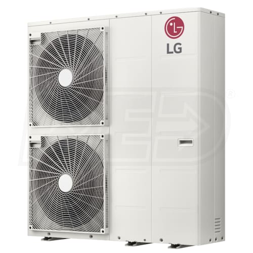

Few months back I heard there were some more legit monobloc HPWH (IE not direct imported from AliExpress, which I've heard people have success with). Found this one.
Maximum output temp is 149F

Monobloc is a lot more up front money, and adds complexity of self-support. It'll be hard to breakeven with an approved monobloc before you go off NEM2. If you import one yourself, you might have a chance. Since it's probably going to be hard to find an installer in California to service the approved LG monobloc anyway, might as well be naughty and import one.
That's the thing - the device itself isn't really that expensive (I got mine for 1900 Euro including shipping from China), but of course installed it myself. I don't get why the regulations need to make everything so expensive over there. Even if I would have 'outsourced' this to a plumber, it would only have cost a few hundred to do the install, no permits needed.
That LG is the only monobloc eComfort has. It's a pretty immature market. You can look up SanCO2 prices if you want, it's likely even worse (and likely requires a HVAC license to install since it uses CO2 refrigerant, being a split system).
A lot of plumbers already give F-U quotes for the simpler Gas -> HPWH installs ($1000 labor is normal, $3000 labor = F-U price), and I'm not sure a standard plumber would touch something even more niche.
