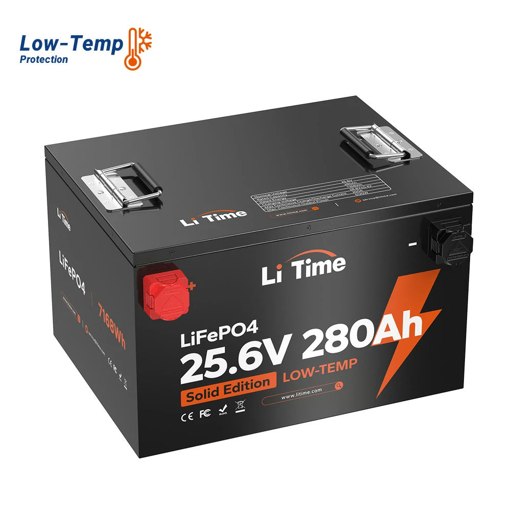

I would suggest you buy a pre-made battery to use. Something like a 24v280ah LiTime battery.
And sell your cells to recoup the money. The needed tools and know-how to do it safely takes money and time. Your short time until you need them means you don't have the time to learn.
I say sell verse store because they would need to be carefully charged individually with a bench supply or they will eventually go flat.
I might actually be interested if the price is right and we can arrange a meeting. Post a price here or start a thread in the for sale section...list where they came from...not looking to take advantage.
Heating your van with solar is a non-starter... electric heat consumes so much power you don't have the room to mount enough panels to charge it. You need an external diesel heater or similar. Using the alternator to charge the battery would require a much larger battery bank.
25.6v x 280ah = 7168Whrs
7168Whrs / 1500w heater = 4.8hrs.
The heater cycles so maybe twice that ....
200amp 24v alternator = 4800W per hour so you would have to run the engine 2 hours to charge.
There are losses so 80% of those numbers is more realistic.
