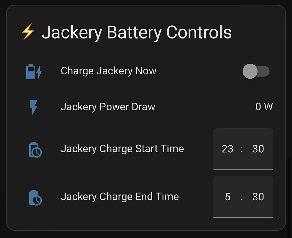

Been reading through this thread. I use the UPS mode on my gear because I want the benefit (knowing the power cost).
The whole battery-full-not-passing-solar thing is really puzzling. My Bluetti stuff prioritizes solar for loads, and draws from battery, and below a set threshold, pulls from the grid.
  • If Load + Battery charging < Solar, solar is throttled (since I'm not grid interconnected).
  • If Load > Solar, battery doesn't get charged.
We're having a weird day today (overcast morning), but the delta between the yellow and the blue is going into charging the battery. The orange is the grid input into the inverter (AC500).
View attachment 304340View attachment 304381
Edit: My solar went to 0 after all my batteries fully charged. Now I'll get 99-100% cycling from battery-solar since my transfer switch is pulling from the inverter (powered by the batteries).
Yes I definitely get this cycling effect and watching the solar go unused has me contemplating either an additional battery or increasing my load. I have 8 x 420w panels.on the roof. My day load is around 800w and I use daily around 10kWh.
I have 8 400w panels (+ 2 200w panels) and a base of about 500w continuous. My entire house uses about 20 kWh/day spiking to 26 or more if I’m doing laundry or running the window AC a lot.

Sounds like you're doing what I did - supplement the house, but don't have the complication of grid-tie. I essentially have a 20 kWh solar-backed UPS for my Fridge, Freezer, kitchen, room AC, laundry, furnace, computers/TV/Internet. Basically everything except bathrooms, Stove and Dryer.
