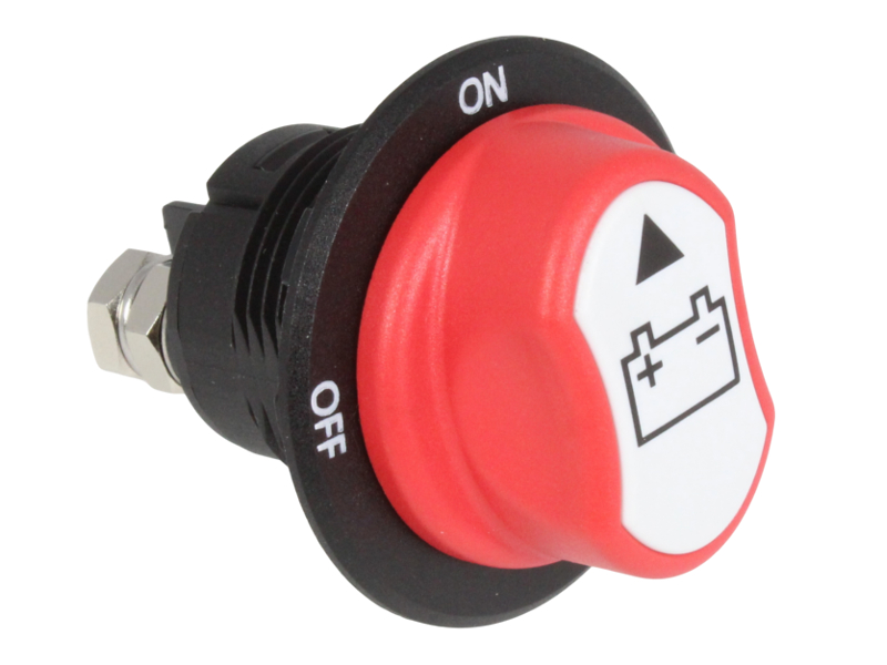

In that case I will connect them so they can charge together. I would like a way of adding a switch of some description to stop me using any of the 100ah battery for anything "unimportant"
An isolator switch could be added to either battery or both.
