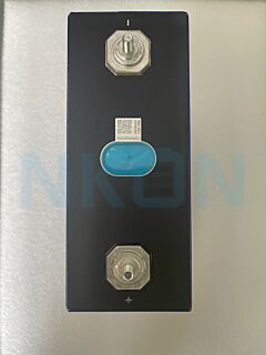

Eve LF304k cells the cheapest I have seen them at NKON now, but they are 2023 dates and threaded studs, not the nice new style v3 terminals which come from Eve these days. Yet the listing claims they are v3 cells direct from Eve 🤔
But… “some cells are a little thicker (up to 73.5mm) ” which sounds dodgy as hell to me. Pre swollen cells with wrong terminals and not from this year, but €2 per cell cheaper than NKON sold me the “real deal” unswollen v3 cells with correct type terminals earlier this year - I’ll pass thanks!
My own opinion is there’s no way those cells are thicker than spec sheet value unless they are used or somehow abused during capacity testing (eg discharged too low). And I don’t believe the “these cells come direct to us from Eve” bit. That maybe applies to the listings for the more expensive cells with the right terminals on.
ETA: so how does this price compare to the $56/kWh in the thread title? Well the LF304K is a 1KWh cell, near as dammit. $82.95 per cell pre shipping cost is $91.73, but that doesn’t tell the full story as it is already landed in EU with taxes paid. I’m going to guess the NKON markup on these cells is at least 20% to cover the risk of warranty claims and shipping damage, plus their staff costs etc and VAT within EU is at least 20% so I reckon the ex-factory cost from Eve must be around the $56/kWh of the thread title, however unlikely it sounded when Will first posted it up.

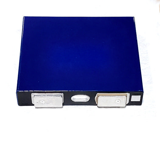

Battery Clearing House is doing 50% off all LifePo4 through the rest of this month and they have 95% capacity new 50ah prismatic cells for $12, which works out to 6.25 cells per kwh, which works out to $75, or $37.50 before shipping ($250min order).
These?
Doesn't appear to have terminals and I'm not seeing a brand name.
I would stay away. You can get "grade B" REPT 280AH for ~$69 each with free shipping ...
These?
Yep those, definitely not plug-and-play grade, some sweat required. But! When you need that rock bottom price point and are willing to trade effort to get it, it's always nice to have the option.
They look to be these:
And it looks like the top plates have been broken off, but if you zoom way in, it does look like a thread swirl in there. Maybe possible to drill the center and ez-out the remains of a broken bolt. I've been wanting to buy a few to check that out, but have my hands full at the moment. They're an intriguing value, imo.
