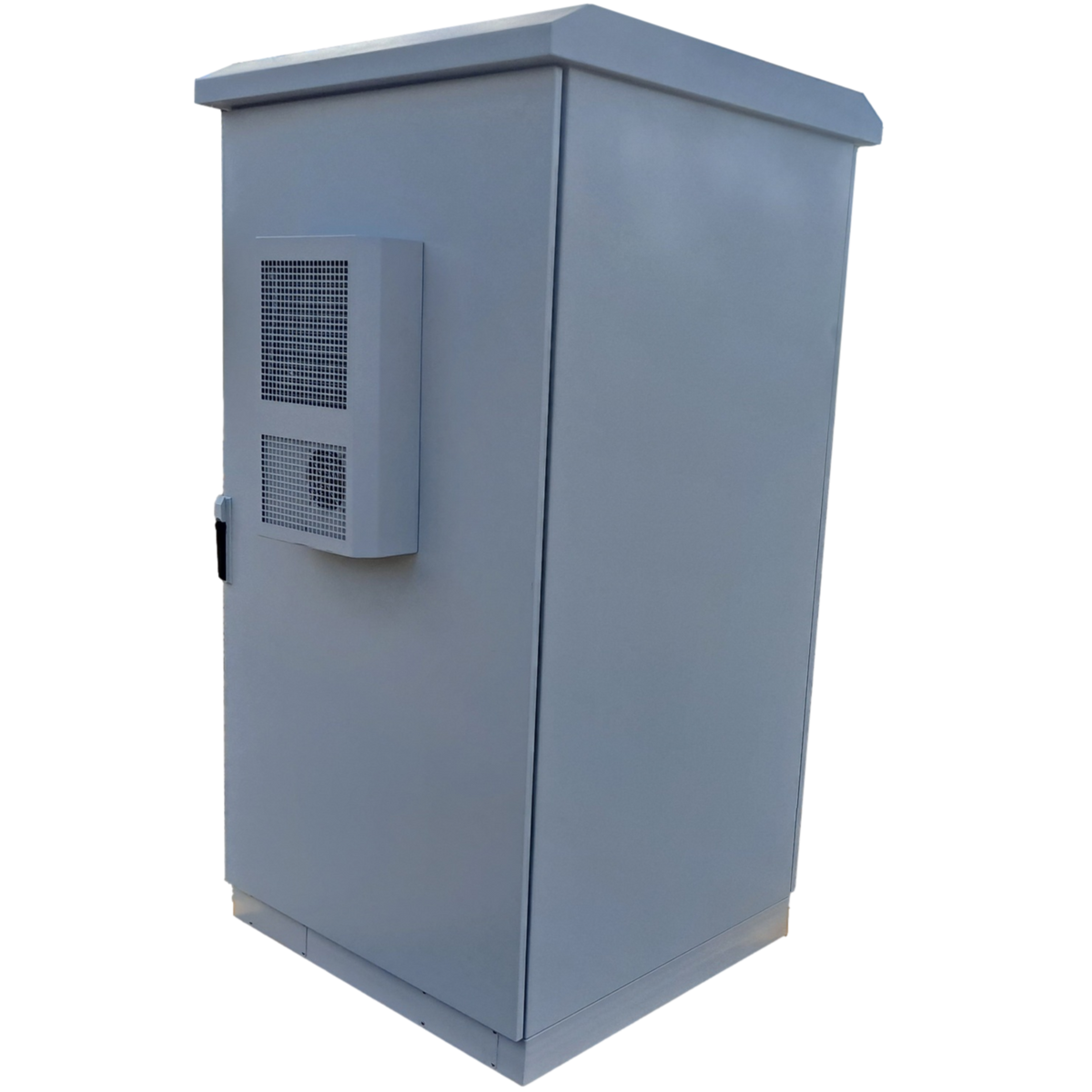

I don't know how big your build is but Batteryhookup has a custom made shed for bigger systems. Probably overkill for almost everyone here.
