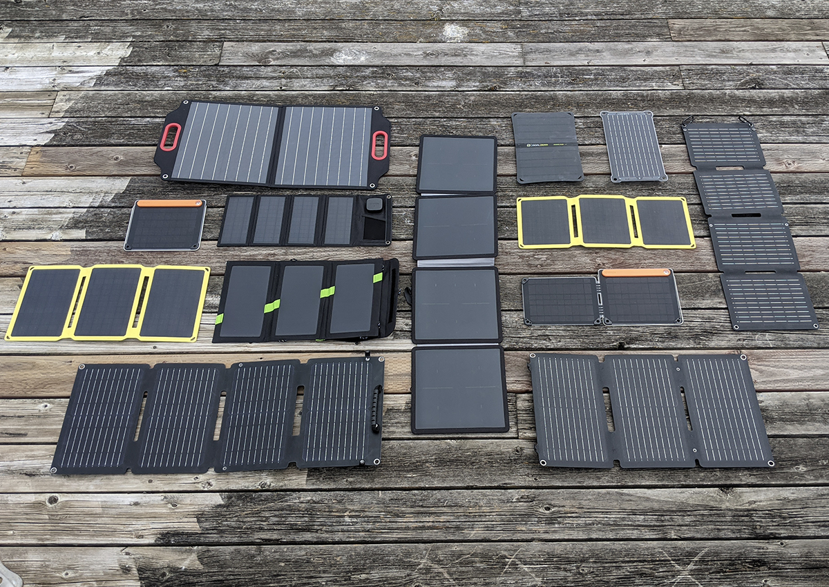

I started looking at them on amazon, and even a 40w panel such as this one weighs over 3 lbs. Then I wondered how much time the panel would actually be in good sun to charge the batteries (likely little unless you took a break for a few hours mid-day just to charge) and the panels don't charge a phone quickly. After thinking about that I realized I'd be better off taking a larger or 2nd battery pack if a single 10k pack wouldn't suffice for my trip. Keeping a phone on airplane mode still allows GPS tracking, so if you haven't tried that you may be surprised how long a full battery lasts. Bottom-line: in my opinion, for solar panels lightweight and functionally useful do not go together for backpacking. Just my 2 cents for my situation, acknowledging that yours may be different.

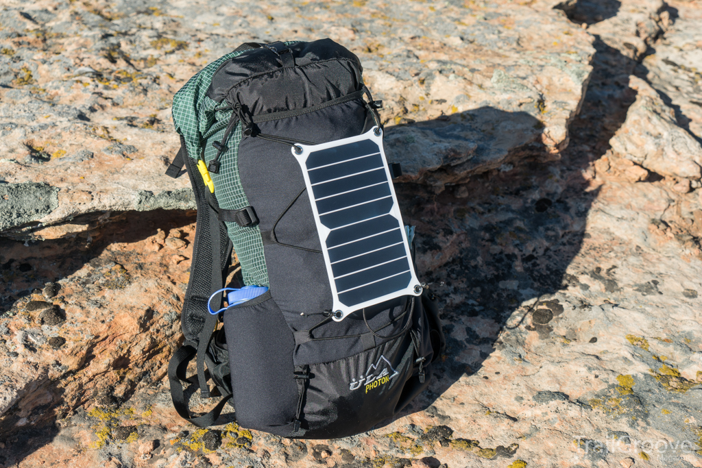

If you want ultralight, this Lixada is hard to beat as it weighs a mere 2.8oz.
Before you buy, read all the reviews - the panel is actually a 4-5W panel (not 10W as advertised).
Also there are some reviews which mention ways to improve the design by replacing some weak hot-glue with epoxy.
I've done backpacking with this one and it does work, and is by far the lightest panel out there, as long as you are OK with the limitations.
Edit to add: regardless of solar panel type, you'll generally get much better results using the panel to charge a battery pack, and then using the battery pack to charge other devices. If you have your phone plugged directly into the panel as you are hiking, power fluctuations tend to kick the phone in and out of charging mode, which wakes the phone up, and can actually use more power than is being generated. This doesn't happen if plugged into a battery pack.

So - Hiking Solar Panels;
Our conclusion was they are heavy & limited for charging. Thus we opted for the Anker battery packs.
