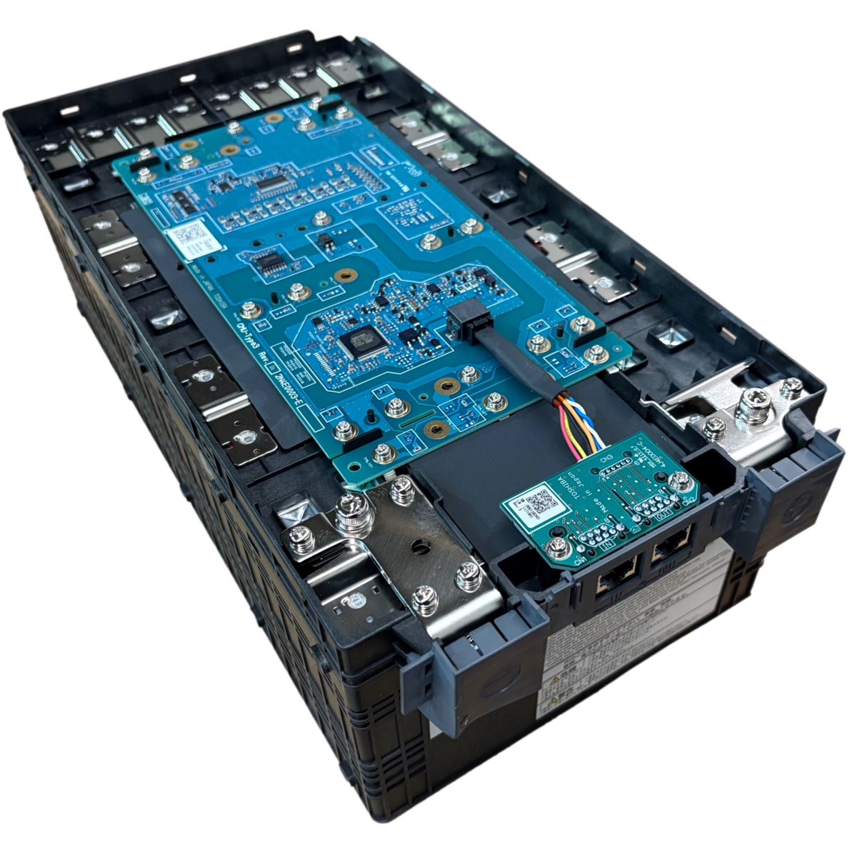

I am trying to help my son with lighting in his utility trailer. Currently, the trailer lighting is wired to run only with it plugged into the truck and the truck on. Not very user-friendly for his business. So we are looking at a stand alone battery/lighting system. The utility trailer is located in Minnesota, so the working temperature range is 130f? to -40f. I'm not sure on the upper limit, but am assuming the trailer could get that hot in the summer. A typical highest outside temperature for the year might be 96f.
With the temperature swings I was thinking of two solutions for a battery, AGM or LTO. We talked about both solutions and we would like to explore LTO.
The big picture looks like the following. Purchase a used 40ah 2p12s LTO battery. (See link below) Add an appropriate bms and fuse. Add 24/12 led lights, wiring, and switches etc. For charging I was thinking something like a Victron Orion-Tr Smart DC-DC charger. I was also thinking about getting a 12v 25w thermostatically controlled silicon heating pad for winter use. The battery would be in a insulated box. But the bottom, front, and heater would be easily removed for summer use. The thought is his battery should charge while driving to and from the job site. I'll plan on adding a spot for a battery charger. We don't want to put any holes in the roof so no solar charging.
Does LTO make sense or is AGM a safer alternative?
Any other thoughts?
Thank you in advance.
Ed

I didn't look at the link you posted last night, but you're thinking of going 24v, that battery from Battery Hookup would be super easy. I haven't seen too many folks use the prismatic LTO versions. Can't imagine they're much different as far as output and cold weather use.
