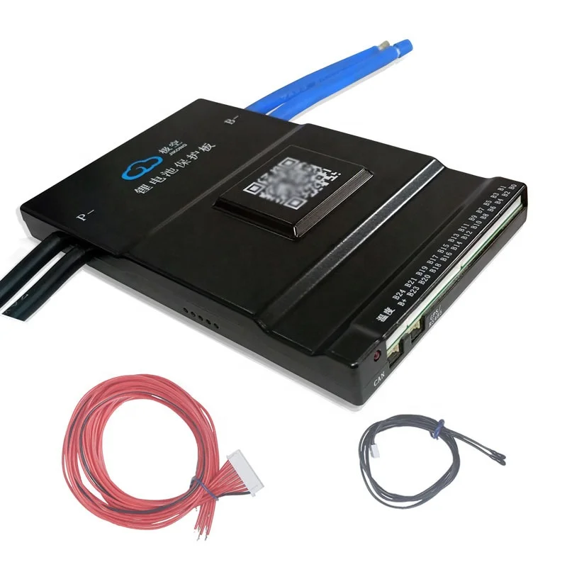

Actually this works for the older JK Bms. On my portable build
That is not true. The original active balance JK BMSs didn't have the plug socket for the display and the on button.

Perhaps mine is a later version? This is what I attached screen to:
One could probably attached to this plate but I decided to just cut a piece of 14 ga sheet metal and will mount my BMS using 3mm standoffs which screw into the backside of the older JK BMS's. This plate will also get a terminal block for the BMS leads and if there is room the Class T gets mounted on the plate or on the side wall.
Nice idea. I ended up screwing a piece of polycarbonate sheet to the 4 screw mounts and used high end velcro from McMaster-Carr to mount the JK BMS to the sheet. Has been holding well. It was vertically positioned. The lead wires towards the bottom of the case and the BMS leads at the top. This way all the BMS leads nicely met the battery terminals.
The ones I have that don't work were bought more than 3 years ago. Anything bought in the last couple years will probably work with the screen / on switch.
old JK
new JK shows plug and socket needed for display / on button.

The 4.3 Display for the older model of BMS has slightly different wiring, they can't be interchanged. Even the On/Off switch is different (2 wire instead of 4 due to no status light). I'm sure the display's are still available. The even older versions may not have the plug for the display. There was 3 versions of the older BMS in the black casing, so a bit of a bugger.
