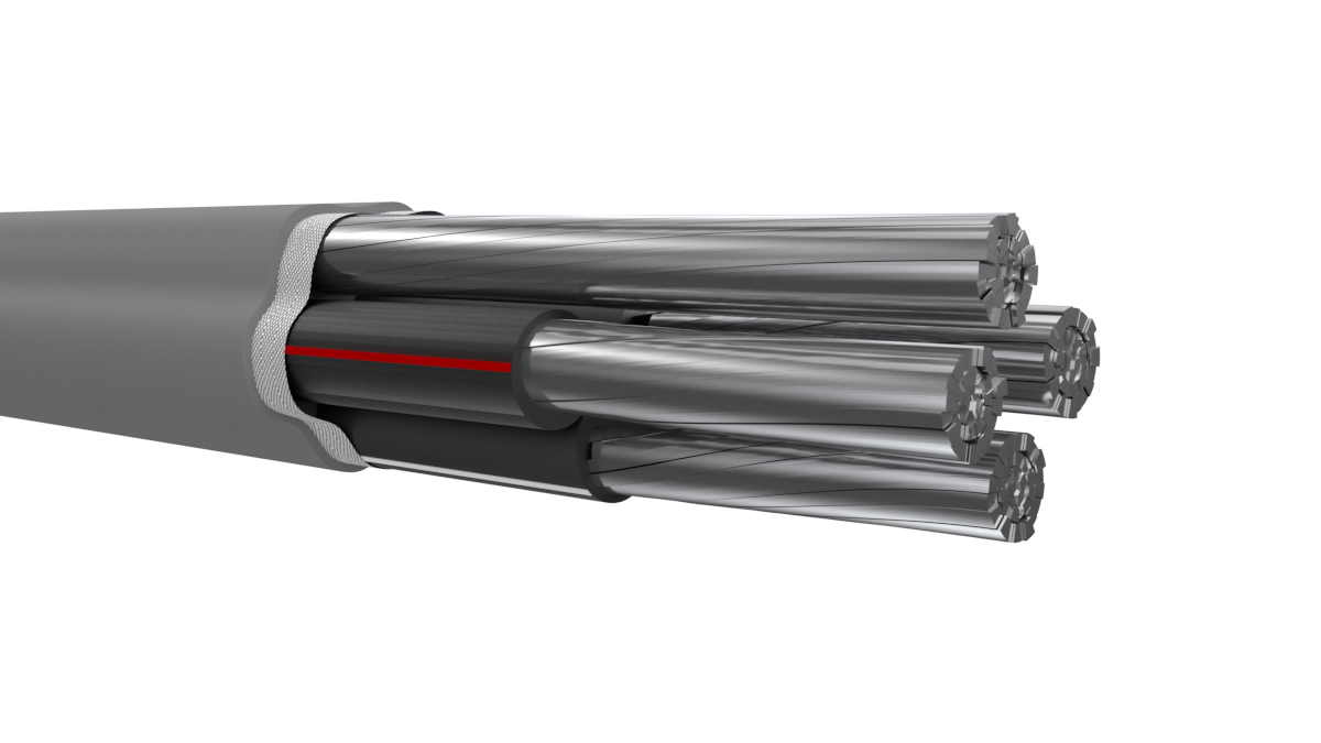

It's indoors, basically going from one corner of the unfinished basement with main panel to the other where Rosie and batteries will be. Can run it along the joists. The Rosie seems to have significant surge potential so I don't want to limit it with any corner cutting on the wiring side. There is a potential to expand to a second Rosie at some point, I believe the epanel for the dual units specifies 100A, but that's prob far in the future.
I would probably do aluminum SER. With the biggest size you are willing to bore holes for through framing. I decided #2 was my comfort zone. It is good to 90A at 75C
Upsizing the breakers is code legal if the loads being served are motor. If you have a combination it gets dicey. The breaker will not instant trip for short surges above the limit
6/3 copper MC is over $4/foot online right now. LOL. I believe that is 65A at 75C
#2 AL SER is back in stock at my local Lowe’s for $1.40 or so
Thanks that is a whole lot cheaper, I'm guessing I would have to transition from the Al to copper on the Rosie side where it takes 6awg? I'll just attach to bottom of the exposed joists, way too many to drill through.
Yes you will have to transition. If you might stack Rosie’s you can do it by preinstalling a small combiner subpanel. 60A breaker for your Rosie and going out a 90A backfeed main into the SER. Then the second future Rosie can go into another 60A breaker. And you can also use this subpanel to feed loads next to your Rosie, which is probably convenient
Price it out against Polaris style connectors. I believe you would be paying $70ish for 3x Polaris style connectors of this size
The sub panel idea sounds good. There will be another breaker for a 240/30A or 50A outdoor outlet to allow for power to some external loads like compressors/welders etc. Maybe one of those RV pedestal type units with duplex 120, 120/30 and 240/30 outlets.
I think it would be easiest to use a standard 12 or 20 space subpanel because of the flexibility. It depends on how many extra busbar spaces those pedestals offer. You could also feed the pedestal off the subpanel.
If this is getting inspected a 200A or 225A would make it easier to pass (but it should pass at 125A for two Rosies backfeeding into it)
Thanks, yes will feed the pedestal from the subpanel. So a 100A breaker in the SER?
So I can get 2-2-2-4 for $1.59 a foot and then 1-1-1-3 for $2.09, might as well go with the larger to be easily within 100A rating?
Sure, go big is fine esp if you know you don’t have to muscle it up into or through a weird place. All the other costs are basically identical regardless of your choice between 1 and 2
I went down from 1 to 2 bc I had to pull a 70’ bundle into the attic and through what turned out to be a super crowded top plate on one side.

Thanks. So do I use something like this for the feed from the main panel? Or does the 1-1-1-3 connect directly to the sub panel, and just have a 100A breaker at the main panel?
For 100A there are three ways.
You can use main lug (no breaker) and rely on the breaker at the main and feeding from the Rosie to protect the wire.
You can use a branch breaker (ie backfed). This takes two busbar spaces.
You can use a main breaker (what you linked) in a main lug convertible panel.
Sometimes main breakers are cheaper/almost free if you buy them in a pre installed package with a convertible panel.
