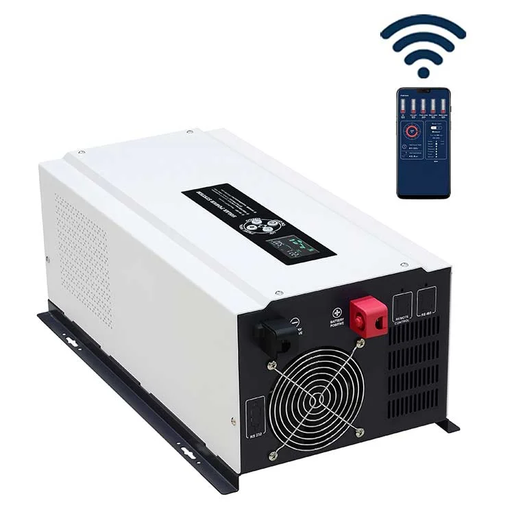

Following my 48V Foshan SNADI All-in-one review, I also purchased a 24V low frequency pure sine wave inverter from Guangdong Xindun Power Technology Co.,Ltd. My sales representative Cindy Lee was extremely helpful and a pleasure to deal with.
The unit price was USD$401 EXW for :
24V / 4000W Inverter 240V 50Hz output
MPPT 60A charging
AC input screw terminals
1 * universal AC output socket
Screw terminals for DC output and AC output
Resettable button fuses for input/output.
Like my 48V All-in-one, this unit allows PV solar charging while the inverter is off.
The unit is quite sizeable, 580mm x 315mm x 290mm and weights approx 20kg.

The internals look well made and brand new. There is a larger fan for the inverter board on the right, and a smaller fan for the MPPT on the left.
20210109_123942.jpg.
Mine actually had some transport damage where 4 of the Toroidal transformer leads had disconnected off their respective spade connectors.
Xindun were able to diagnose the problem from the photos I sent them and sent instructions on how to reattach the leads.

- Mine came with some shipping damage, the glued foam padding on one side had delaminated and the metal wing base of one corner was slightly bent. The toroidal transformer leads had slid off their spade tabs.
- The unit gets surprisingly hot - 39 degrees C reported by the display when PV charging. Up to 50 degrees C when PV charging and the inverter running. Even the white metal shell became quite warm.
- The small left side fan comes on intermittently from 40 deg C and is a bit whiney.
- The larger right sided fan never came on.
- the PV output in watts is incorrect. I am using an external PV combiner box to combine 2 series strings of different voltages. This isn't a problem for the Foshan Snadi, but this unit report an incorrect PV power (W).
- Horrible loud beep every time you press any button, I put kapton tape over the speaker.
- Fairly small battery terminal screws, approx M6.
- Only one AC output socket, therefore you will need to cut and strip an extension cord to connect to the AC input / AC output screw terminals
- When PV charging I noticed the inverter's displayed battery voltage was between 0.2v - 0.4v lower than my BMS/multimeter recorded. Set your inverter HV cutoff accordingly (they as also set as for 12v, like Renogy, so 14.4 = 28.8)
- No grounding attachment on the case, I don't know if this is an issue, but other inverters include a ground terminal.
