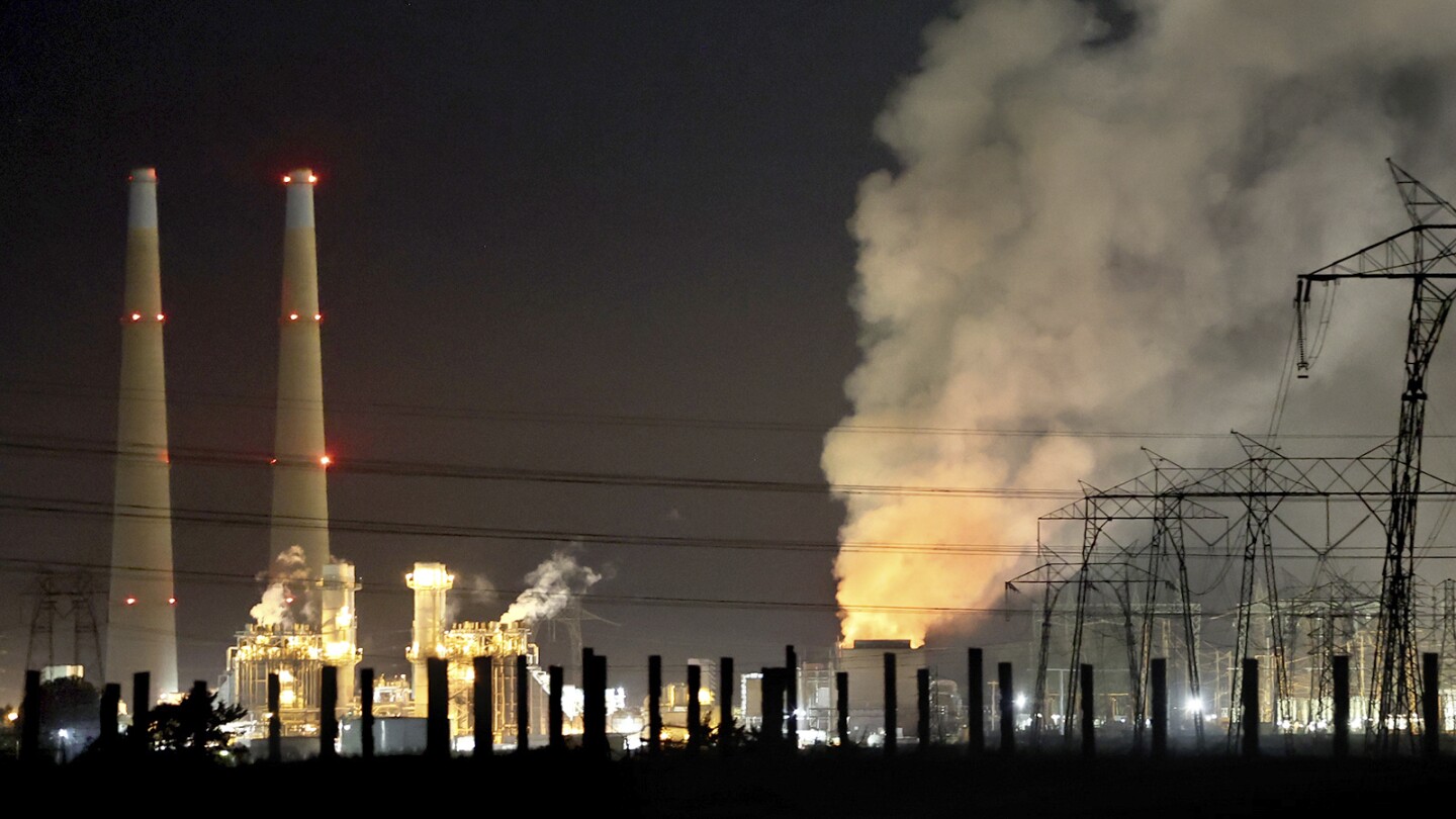

Even the professionals struggle with battery fires.
It is unclear if it is isolated to one of the smaller modules on site, or larger.
It is definitely an intense fire.
One of the largest Li battery storage sites around.
This will create significant NIMBY pushback for future battery installations.
If I understand correctly, there are actually two different battery systems at Moss Landing. One by Tesla and one by another company. I wonder which it is.
I also wonder what chemistry the batteries that are burning is. My first guess would be NMC. I would think they could control the fire better if is LiFePO4. Unfortunately, most of the world will not understand the difference so this fire will create pushback on new installs of any type of battery.

The Moss landing installations are an interesting case study. If you look at the pictures of the fires, you can see big smokestacks. Those are from a decommissioned power plant. The infrastructure for power distribution was already in place for the power plant so that makes it a great site for a utility-sized battery bank. Unfortunately, it is right on the banks of the Elkhorn Slew which is a marine estuary. Hopefully, they are containing the run-off from the firefighting and not letting it get into the Slew.

Apparently this was phase 1, a 300 MWh capacity config all in one building (two stories of batteries). A Fluence/LG design.
Crazy design compared to tesla megapacks where a single container can burn outdoors without destroying entire battery array due to spread.

Not sure there's any other batteries like this all housed in one giant turbine room so once one module goes up it's lights out and massive fire for days...
"Housed inside the power plant's completely refurbished former turbine building and spanning the length of nearly three football fields, Phase I of the battery system can power approximately 225,000 homes during peak electricity pricing periods. The system is made up of more than 4,500 stacked battery racks or cabinets, each containing 22 individual battery modules, which capture excess electricity from the grid, largely during high solar-output hours, and can release the power when energy demand is at its highest and solar electricity is declining, usually early morning and late afternoon."
I thought the Tesla battery containers were already placed a bit too close together, but this is just absurd—two stories high?
It feels less like a question of if a disaster will happen and more like when it inevitably will.
