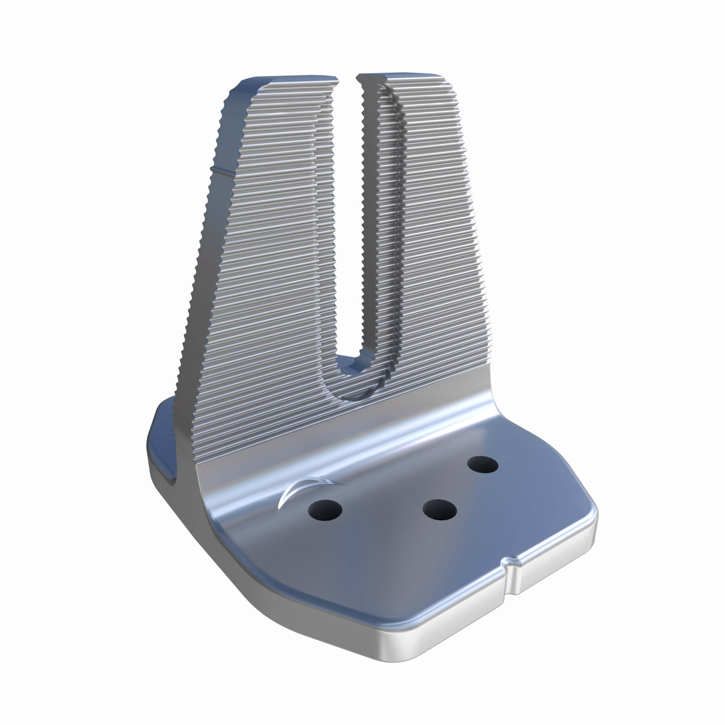

I had good luck with my painted-shingle roof with the Iron Ridge HUG mount:
2 screws if you hit the joist, but you can do up to 6 if you miss. My joists aren't straight or on particularly consistent centers, so I have a few that needed all 6. I can see them in the roof of my boathouse, but don't really care. If you have a ceiling under the roof you should be OK, or if you can hit the joists.
