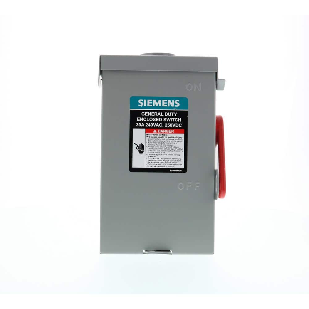

Why add a breaker a when all you need is an appropriately rated safety switch?
1) In this particular build, there needs to be two separately controllable disconnects. The cleanest way I have found to do that is to use the Din rail breakers.
2) The cost of properly rated switches is typically higher than the cost of the breakers.
what is your voltage?
Make a deadfront/bezel out of plexi glass.
Attached to the breakers with velcro. At the flat surface between the terminal screws.
If you hunt around, you can find the IMO for 72 bucks x 2= 144 bucks
If they are that hard up for money, probably should not be building a system.
In that application we use a few dozen of these a year. No problem passing inspection ever. $27
That is indoor rated, the NEMA outdoor rated is higher.
Trust me, it's the same one. Some sort oddness with HD website. As I said.... $27 rated for outside, passed inspection dozens of times with it outside already.
It isn't the same, it doesn't have the cover on the top. :)
I know what you're saying but NEMA rating is a NEMA rating for exposure. Many times outdoor rated is galvanized metal, the indoor isn't. Take for instance Siemens PV rated disconnect, the outdoor rated box is made of aluminum so it won't corrode.
It's like fake meat, while it might taste the same (it doesn't), smell the same (it doesn't) and look the same (it might), doesn't mean it is meat. :LOL:
