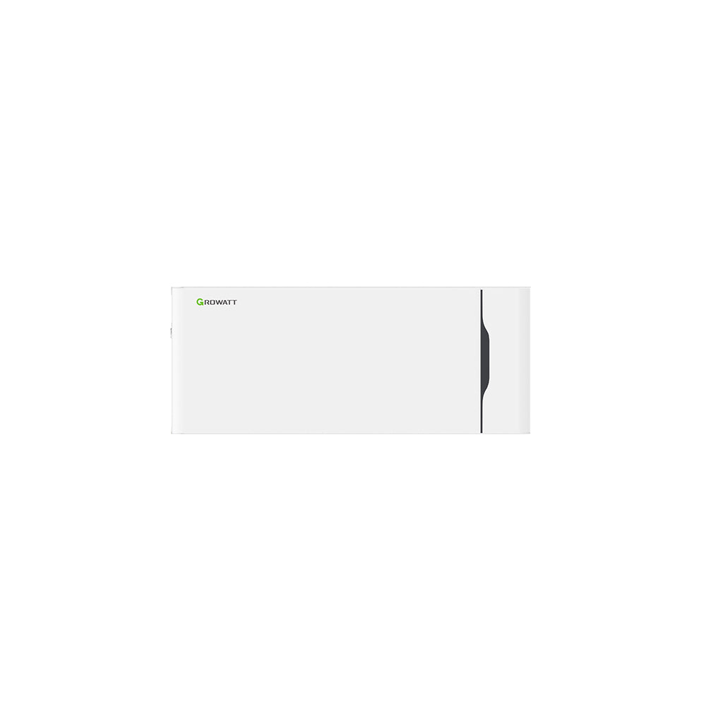

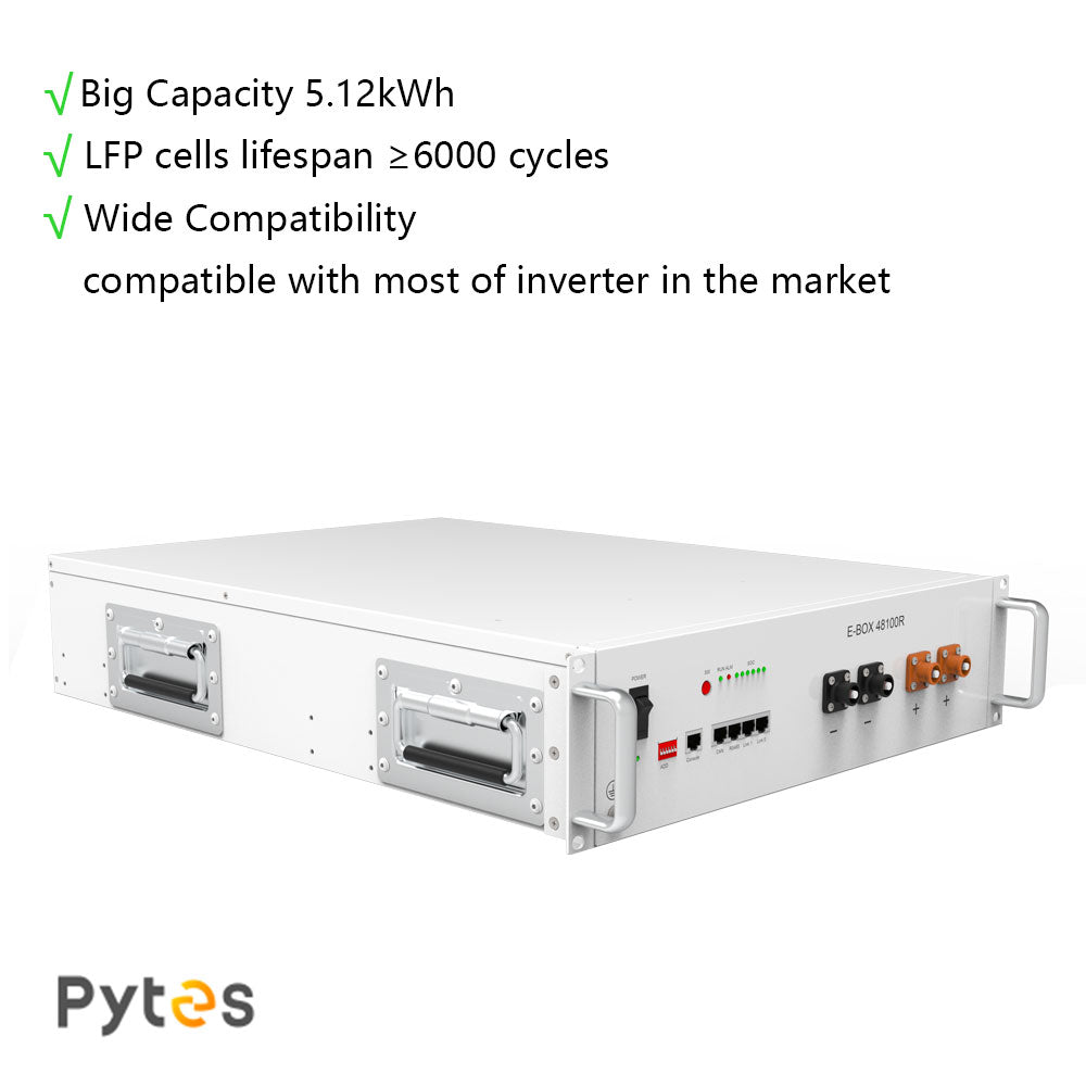

Honestly, it would be hard to go wrong with the Pytes option you listed, the Ruixu option, or even the Growatt ALP (which I have zero experience with). Are you needing a heated battery, or no?
I'm leaning toward the Growatt and RUiXU with Pytes being the last choice.
I don't need heated as the batteries will be indoor.
The RUiXU batteries don't have UL9540, it's pending and it's needed in Arizona as far as I can tell.
