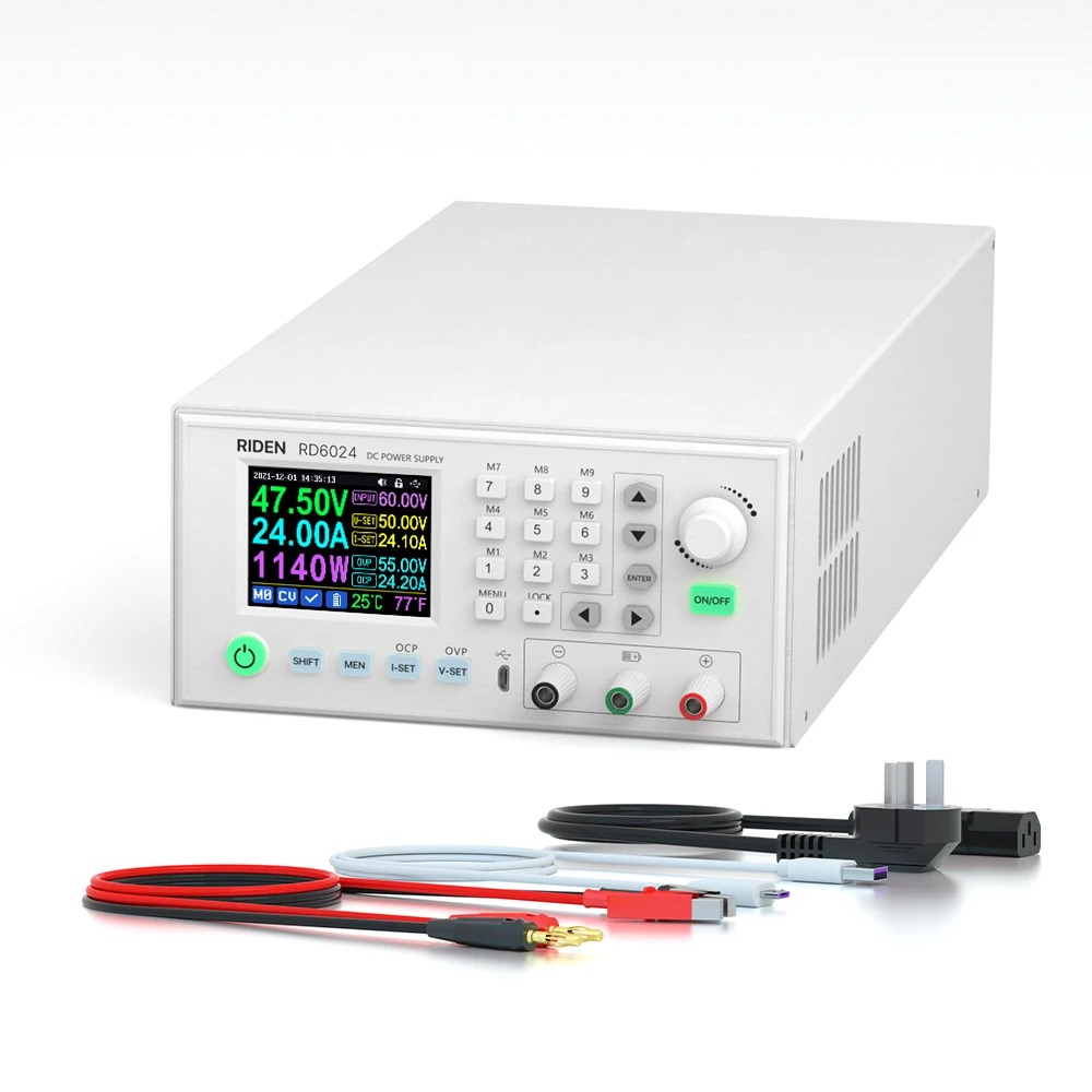

Hello, first post. Bumping a thread. I just recently ordered a RD6024, no box or power supply. It is enroute from China and I am supposed to get it in a couple weeks. So I need to get a power supply, been looking at the above mentioned ZJIVNV 1500w power supply, seems decent. It is on Amazon right now for $135, link below. The two obvious choices seem to be what they claim to be the 60v/25a and the 72v/20a, yeah their math for watts is not spot on. Both types claim to be adjustable +/- up to 15% on the volts. Which way would you go, I'm leaning to the 72v and adjust it down a bit....I assume the Watts would remain constant and the potential amps would go up a bit, turning it down to say 68v.
For what it's worth, I bought the 60v/25A model and there is a pot next to the connectors for the wire that you can turn it up. I think I set it to 62v and left it there. It works great.

I just requested an offer on their Alibaba site for a complete assembled set RD6024 1440W see the product link below.
Am I right in thinking that this set is indeed equipped with a 1440W power supply (under 220V AC) ?

The Amazon listing only sells the DC-DC converter faceplate.
The Alibaba listing sells the complete kit with a power supply (1500W PSU), factory-assembled and ready to use right out of the box (which is what I bought).

PS: Remember to specify that you want the 110V version of the PSU if you are in the USA.
That's what I was thinking, but the images for the Amazon listing does show all of those three components. The price is too good to be true.
I missed their last bullet point in the listing:
  • Integrated panel, you only need a shell and a AC-DC power source to form a powerful and adjustable power supply.
