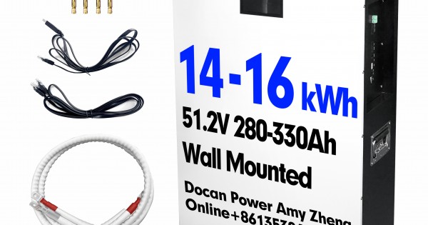

Compared to another 280Ah+ battery? I agree the gap is close on rackmount 100Ah, but 280's are still worth it IMO.
I'm comparing to the cost of building my own box out of metal. The cost of steel, disconnect, fuse, bulkheads, JK BMS, and hardware. Sure you could just buy a cheap heavy duty shelving system from Costco if you have the room I don't. Would still need a BMS, and wiring per 16 cells. This was the total price with EV grade 280s and a box. I will move my class T blue sea fuse and fuse holder to the the line between the inverter and my battery banks. I haven't had a chance to build the boxes yet need entire day where I can focus on it. I did weld up a heavy duty cart with 2200 lb casters I need to be able to roll the batteries around if needed.
If products ship by March 10th and are imported here by April 12th, the latest 10% tariff on China doesn't apply.
I'm not a fan of having cells lay on the sides.
