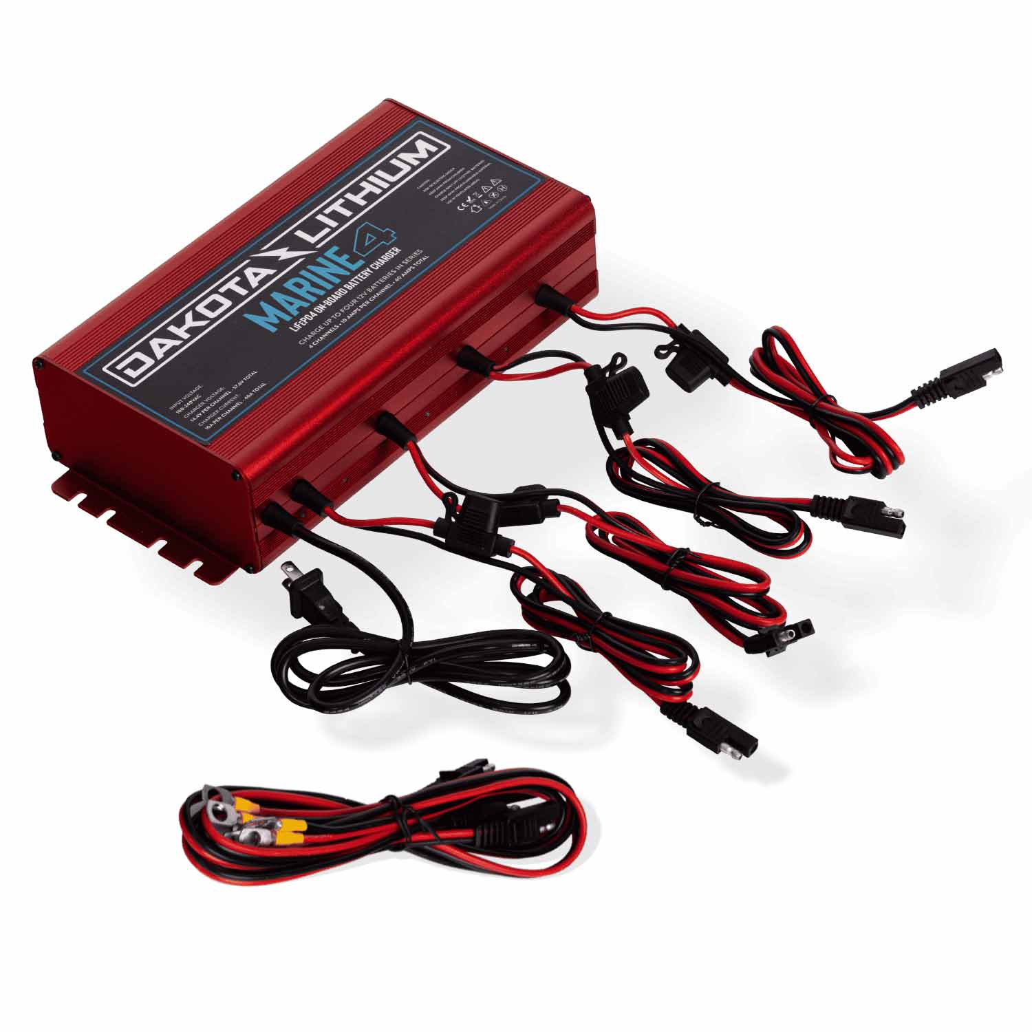

I connected a Dakota Lithium Marine 4 bank 10-amp charger. Each bank is 10-amps totaling 40amps.

The battery charger is a 10amp x 4 (40amp total) bank Dakota Lithium charger. It is an onboard charger for the boat.

The battery charger is a 10amp x 4 bank Dakota Lithium charger. It is an onboard charger for the boat.
