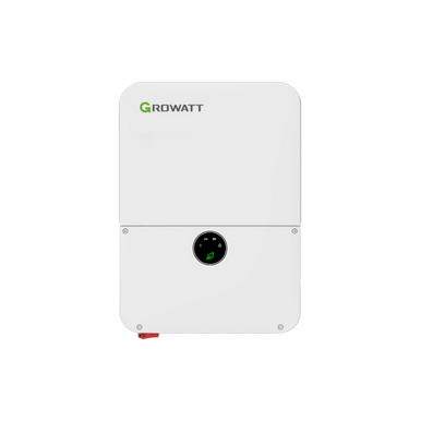

The 11.4 Growatt grid tie inverter for $1800 with the 15kw PV makes sense (thanks 1201).
Not really. Sig solar recycles the samec sales every couple of weeks
This is the grid tie inverter to get
$1700.
If you think you'll ever want to add a battery and critocal loads panel, spend a little bit more and get this one. It works without batteries but you can easily add a battery later
$2500

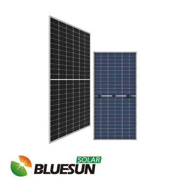

Found these panels on sale for almost half the cost of the BlueSun panels, any thoughts?
or
or
voc and vmp checks out. I would get the cheaper panels.
The SSM panes are 560w, VOC 53.5, VMP 45.7, ISC 13.1a
I was planning to order 22 panels, 12320w total
The max MPPT voltage for the Growatt 11.4 inverter is 550v, does that mean a max of 9 panels in series. 9 x 53.5= 481.5 x 1.12 = 539?
If so that would end up with 2 series string of 9 panels each and one series string with 4 panels all in parallel. Is that ok? Should the strings be exactly the same?
The growatt 11.4 will accept 4 different MPPT, should I plan to run each string in separately or combine them and run just one in?
The growatt 11.4 can do 600v so you should just be able to fit 10 panels per mppt with your 1.12 correction factor.
Strings can be different since the mppts are independent you could do 8,8,6
Always order a couple of extra panels just in case. So order 24 and if none break then just do 3 strings of 8.
I have 15kw of PV attached to my 11.4
14,14, and 11
DO NOT combine them. Run them all separately. The 11.4 cannot handle high amperage

Back looking for help. I'm trying to complete the attached NMIN but struggling with the terminology. When I spoke with my local electric folks they emphasized the need for this form to be completed correctly or there would be delays. Specifically sections 3 & 4.
Panels are the SSM 560w bifacial https://www.santansolar.com/product/santan-solar-ssm-560w-mono-bifacial-solar-panel-grade-b/
Inverter is the Growatt 11.4 grid tie - https://signaturesolar.com/growatt-...3NM8ChcHUXb8POxMUWm7WO0djGNlabXkbV0L039xSYCSH
Thanks in advance
Section 3. Information for Facilities
Inverter Induction Synchronous
Number of phases (check one): One
kW; AC 11.4 apparent kVA11.4; AC real kW;11.4
Generator Type (check one):solar
Frequency: Hz; 60
Rated Capacity: DC 11.7
Power factor %;1.0 AC voltage 240 ; AC amperage 47.5
Facility schematic and equipment layout must be attached to this form.
1201, you have been a true resource and it's appreciated. Be happy to send a little your way for a consulting fee...
Where did you get the rated DC capacity is 11.7?
How about the AC apparent & AC real are both 11.4?
Trying to learn along the way if possible. Thanks
No fee necessary. I got a lot of help too. 👍.
11.7 is the maximum DC it will use. At 97.5% efficiency that allows it to output 11.4kw
The power factor is 1 so apparent AC and real ac are equal at the rated maximum ac if the unit(11.4 kw)
