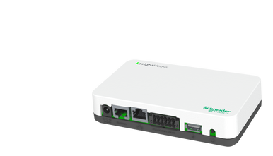

Consider a Schneider XW Pro on close out for around $1400. Still has 10 year warranty. 6.8kW but can surge to 12kW and beyond.
Needs an Insight Home to program, sig solar has them for $143:
