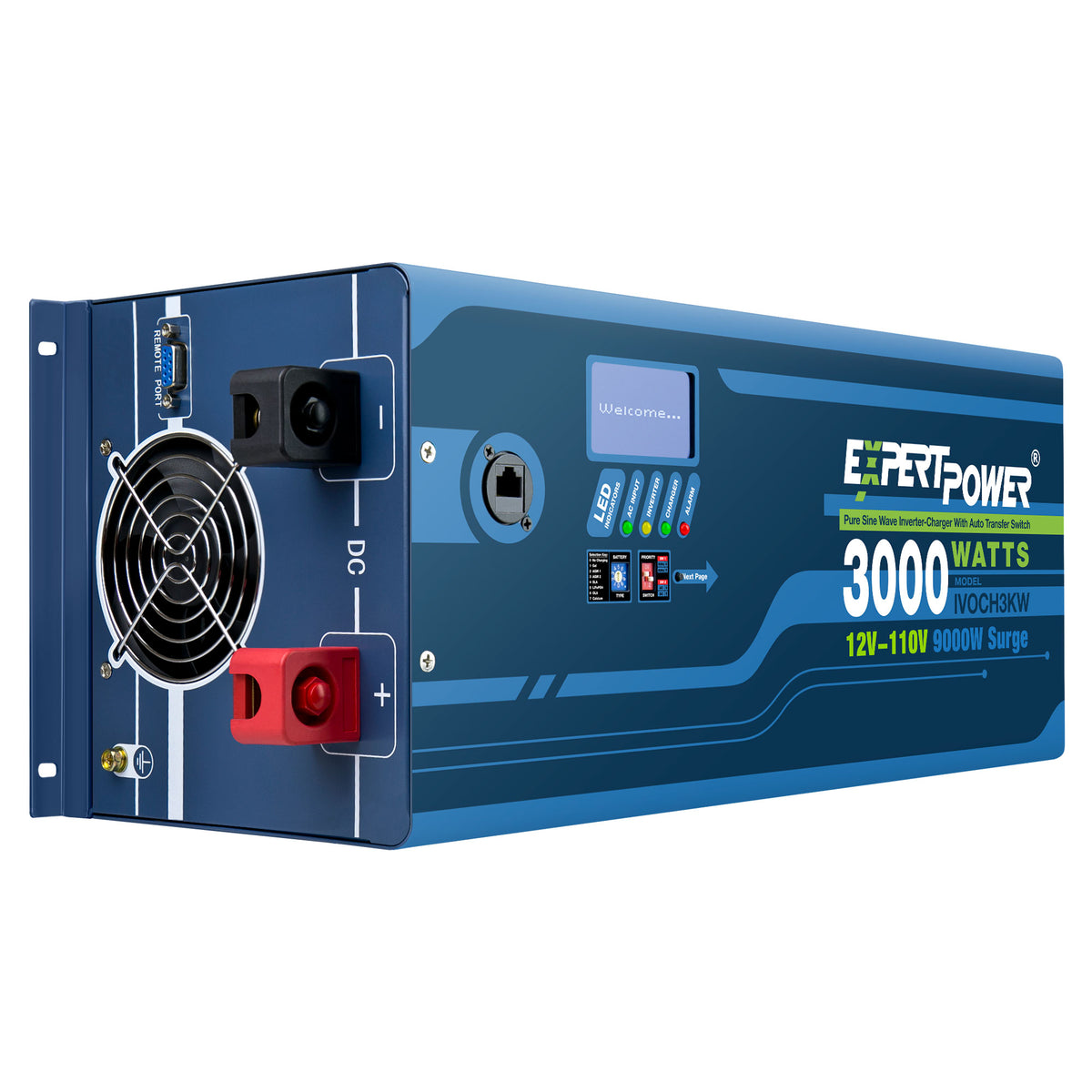

So, maybe my definition was off - since they get off - I was thinking of something like this -
or its cheaper cousin
AC in, auto transfer switch, separate AC out/load screws with no backfeed connection and no solar unless they want to add it
Multiplus ll can export.
The other one probably not.
I think that what you are trying to suggest is an off-grid AIO.
Which would simplify the installation.
But for what they actually want, just a plain stand alone inverter, battery and Chargeverter would be ideal. (Still gives the option of future solar)
A second Chargeverter for the generator. Or a small automatic transfer switch, for the single Chargeverter.
Yes, that is what I mean in my fumbling way through the forest of defining what things are called
