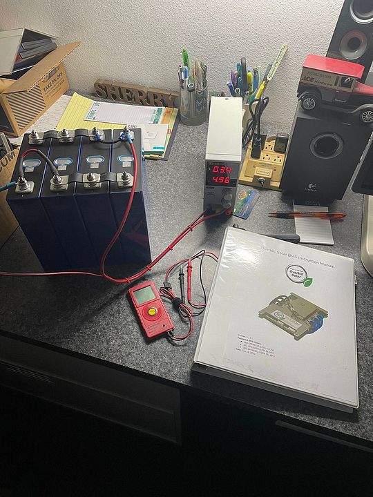

My 4 LF230’s arrived today. Beautiful, good packing no damage, read the QR codes they were all made within a few days of each other in june last year, all measure 3.290V.
Only problem is one terminal is missing its threads. :(
Someone posted a link for post adapters to M10 and those will work nicely.
Waiting to hear if I should try tapping threads or return the one.
I wonder if high conductivity glue would be a solution? I’d probably want a refund on that cell before I attempted.
Tap it. It's really not all that hard. If you have never done it before watch a video on the subject.
Yeah, I'd tap that.
Lol. Yeah, tapped it, grub screw locktited in, it’s solid.

Broke out the new power supply last night, installed all of the grub-screw terminals, hooked the cells up parallel, and put the charge on them, initially to 3.4V. They've been on for over 18 hours and have only gained about 2 tenths of a volt. LOL They started out drawing about 9A, now down to 5.
I'm doing the step method - to 3.4V and rest, then 3.5 and rest, then 3.6, call them balanced. I'm guessing the second and third steps will go quicker.

It takes the LF280N between 70-76 hours to parallel top balance with a 10amp power supply.
