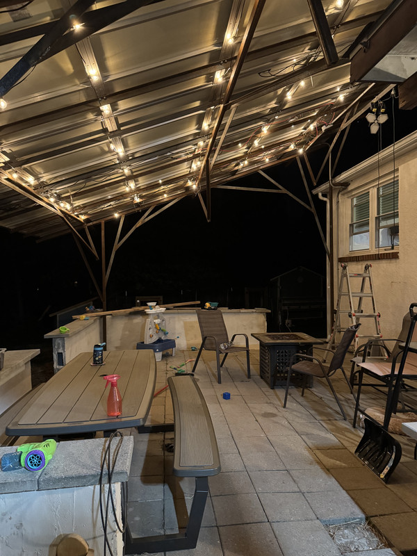

I have installed 3 costco pergolas for friends. Their quality is horrible, and while it'll probably hold a few panels, I wouldn't trust the structure itself to last 10 years. They'll never stand up to wind load which is why they're open top with cloth.
They don't say what they define as heavy gauge aluminum. 12ga? 18ga? Big difference. My shop joists are 12ga steel and I wouldn't trust them for a pergola.
My pergola is 1/4" steel and it's about as thin as I would go. And I engineered the hell out of it.

Looks like you are also using 2" square tube? If I'm building it myself, I'd probably used 4", or 6", and be able to go down in wall thickness too.
