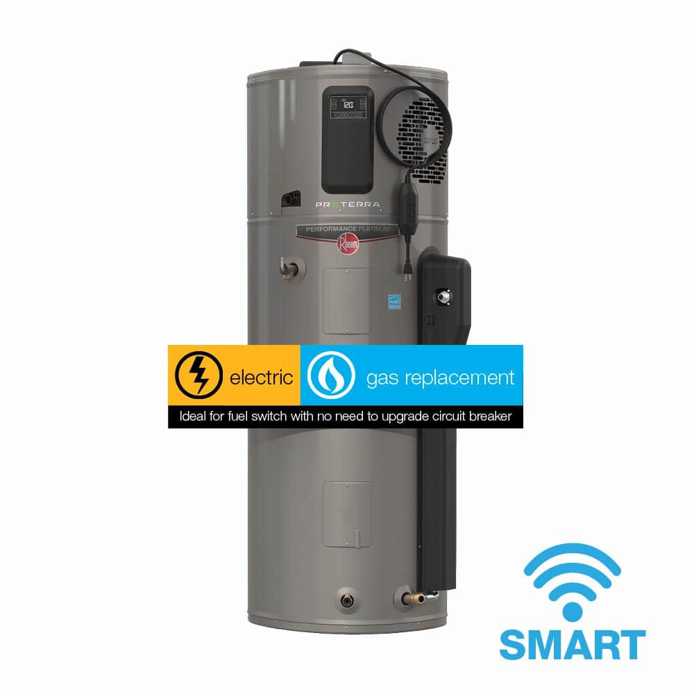

I want to snag one of those tanked heat pump retrofit jobbies marketed for converting from gas to electric, they run off 120v. They aren’t really designed to work beyond the south as they have no conventional heating element as back up.
Seeing we’re not heating water past frost season, it’d be perfect for us and double up by helping cool the first floor of the camp when we run it. Sadly she says it’s too expensive (she ignores the federal rebate) so we’ll make do with the on demand.

Instead of tankless, consider a heat pump/hybrid water heater. Drops your power needs from 4500w to 600w (mine is closer to 450w), easily run off a power station. Down-side is that recovery time is much longer, so in a home with a lot of users, it may not be enough. Mine works out fine for me as hot water needs are minimal.
As long as there’s heat to pull from.
In our basement it’s unheated until I get the wood boiler going. If I run the heat pump hot water heater in heat pump only mode in October, it’ll pull the basement temps to ~50f.
That’s why many hybrids have traditional heating elements as back up, and 120v only heat pump water heaters are only recommended in warmer climates.
