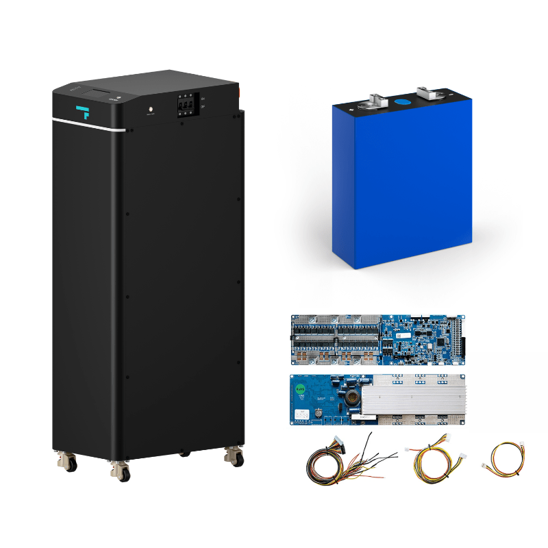

Fogstar Energy 30kWh 48V Rack Battery Bundle - £5999 - 30 kWh - 20p/Wh (or 23p/Wh with hybrid inverter)
Seplos V4 kit (314Ah) - £1699 - 15kWh - 11p/Wh

EVE (assuming that is what comes in the box) is a reputable brand. You want Grade A cells.
You also have to decide if you want Communications with the inverter, or if you will run in voltage mode. Voltage mode will work with any battery. Communications adds a little bit, since the charge curve for lifepo4 batteries is so flat. Consider the integration of the inverter and battery.
I would go with the Fogstar or Seplos. In either case, you don't have to worry about compression, since that is part of the design of each, and you can't change it.
Fogstar is off the shelf 5kWh rack batteries by a UK Company. Get a communicating inverter, and you are good to go. If you have any problems, you have local support. If a battery dies, it is easy to replace one (although a replacement in 5 years may not have compatible communications, but no big deal). If they offer a nice app, you may be able to see a lot of detail of the condition of each battery. As a UK Company, you can probably trust that it really contains Grade A EVE cells.
With a rack battery, if you go camping, you can pull a battery, attached 3kW inverter, and you have portable power.
Seplos is cheap, buying from China is a risk.. You will learn a lot in the build process. If a cell goes bad, it can be replaced. If you are going to build 45kWh of storage, you might want to source the cells yourself. For the 48 cells, you might be able to get 52 matching cells, and that would give you 4 spares to swap out. If you source the box separately, it would be easier to get a BMS that is compatible with whatever inverter you buy.

Fogstar now do full DIY kits for not much over DIY money, their website is silent on warranty on these kits
Whereas the made up ones can be 8 years.
Fogstar warrants the Fogstar Energy 48V 15.5kWh ("Product") to be free from defects in cells, BMS and workmanship for a period of eight (8) years from the date of purchase ("Warranty Period").

Compression - This is an interesting point. Is there anything to say that Fogstar and/or Seplos has simply ignored it? Is it really a thing? Do other commercial/professional grade units consider this? I've not really seen any research or analysis on this yet. I've not looked too hard though. With watching plenty of if DIY'ers on youtube mess around with compression, I do wonder how scientified the approaches are.
Warranty - Yes Fogstar is a UK company but aren't they really just importing stuff from China and re-packaging it? None of it is designed or build, as such, in the UK.
Grade A cells - You mention this twice, I will research, but I am working to the assumption that the difference between grade A and B is more about capacity than reliability.

I have two seplos masons totaling 30kwh for nearly two years and not had any problem with them and will be adding I aslo set up the seplos facebook page a year ago

I've just ordered 2 Seplos v4 MB31 kits from Fogstar as the Black Friday price is ridiculously low at about £87.50 per kwh.
Do you have a thread regarding your setup? I'm looking at a Sunsynk 8.8kw hybrid inverter for my system, what have you used? Any issues to report?
