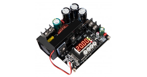

2. DROK 900W BUCK/BOOST that can utilize the high watts of the HP PSs
For $24 shipped this is a good value to use to charge your batteries.
The key is that it can boost the voltage and can take a 12.3v input and boost it to 100V or more.

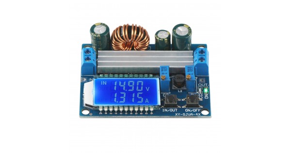

3. DROK 3A
I really loves these to "BALANCE" my cells, I have 2 or 3 of these hooked up to to top off cells @ 2 amps.
