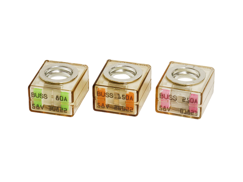

2. A MRBF terminal fuse is slightly better than a class T fuse as it is closer to the battery and results in fewer connection points, so less heat buildup.
3. Assuming 1 and 2 are correct, I was looking at purchasing the following:
Would these be suitable?
4. The fuse will be connected to the positive terminal of the Seplos battery.

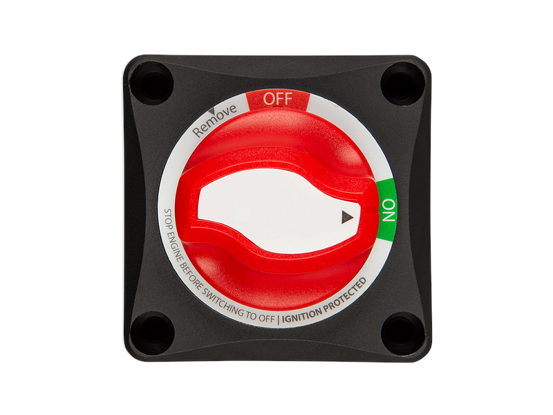

5. Between the fuse and the inverter I should have an isolation switch. This one looked appropriate:

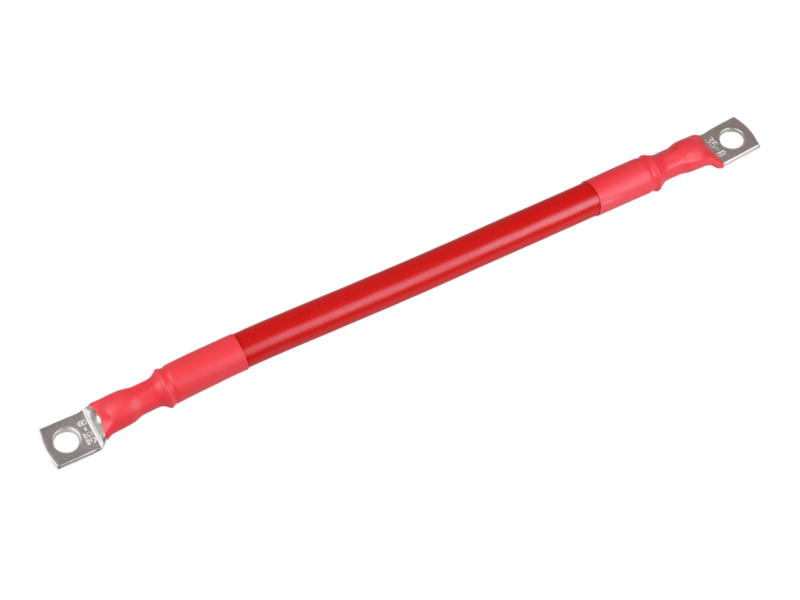

6. The battery cable that came with the inverter will connect the inverter to the isolation switch. I will then need another cable to connect the isolation switch to the fuse on the Seplos battery positive terminal. The fatter and shorter the better. This looked appropriate without being overkill on cross-section size:

(y), sort of. Fuses protect wires. So first ensure that your wires can safely handle at least 125% of the max current, ideally more. And make sure that the fuse is rated lower than the wires can carry. So, my rule of thumb is add 25% over max current for the fuse and another 25% above the fuse for the wire.
No. MRBF is not as good as class T.
But class T fuses are expensive in the UK. I'd recommend NH class fuses myself, but I must admit the concept of the connection point of the MRBF is appealing. See also this thread re testing of MRBF and the slow-mo video on the first posting...
https://diysolarforum.com/threads/dead-short-fuse-trip-experiment-using-an-mrbf-fuse.80773/
No. It is only rated to 48v and you will be running up to about 56V. It is also only a single pole isolator.
I'd recommend using a dual pole fused isolator, like one of these that can be fitted with 125A NH00 class fuse.
https://essandsolarsolutions.co.uk/jean-muller-combined-keto-00-fuse-holder-and-battery-disconnect/
(y) IMHO 35mm2 is ideal for further connections (and bigger than the ones Solis supply) - the M8 terminals will fit the isolator I linked to if you go down that route too.

When looking for a fuse to couple with a 48V LFP pack, you're really trying to satisfy these criteria:
- Fast acting: in case something goes wrong, you want to disconnect as soon as possible. This is in contrast to fuses that are coupled to e.g. motors, since these are not supposed to act very quick due to expected large sure currents on start.
- High Breaking capacity (IR, interrupt rating): a short can produce thousands of amps, you need a fuse that can deal with that.
There is another reason you want a fast acting fuse: in the old days, the saying went "fuses protect wiring, not equipment". This is not 100% correct anymore, since we use fuses to protect things like inverters, and size the fuse based on the maximum current that device should ever see, not based on the wires it's connected with. Same goes for things like the BMS. These are essentially fast acting fuses specifically with this in mind, and are called semiconductor fuses (they contain a diode in their symbol to indicate this).
There are entire subcategories when it comes to fuses. We have things like aR, gBAT, gG, etc. A gG fuse is general purpose, but slower than an aR fuse. However aR fuses tend to have more losses associated with them. It's a bit of a trade-off.
Class-T, as well as BS-88 and NH style fuses (you still have to check: NH fuses can be gG as well, it's just a form factor but they have dedicated gBAT fuses in this form factor as well), contain fuses that provide a balance in this trade-off. They're fast acting, have a high interrupt rating, and are suitable for device protection while minimizing losses.
Class T used to be readily available even in Europe, but these days they're hard to find and have become expensive. I personally use BS-88 fuses on the battery packs since they have a similar-ish form factor to Class T (i.e.m they're rather small), compared to an NH style fuse which are much bigger. I use the NH fuses on the inverters.
In the end, it comes down to checking the datasheet of the fuse you have in mind and make sure it has the required breaking capacity, usable for your application (DC, voltage range, fast acting) and at a decent price point.
