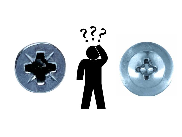

Wow. Thanks for sharing. I’m gonna put a yearly check on my list also. Do we know the official size of the screwdriver that fits into that Phillips type head? I ask because I’ve used the normal Phillips head in the past and when tightening down the head sometimes slips out of the screw head. So I’m assuming it’s not 100% correct fit for the screw and then of course, not sure of what the actual torque is. Plus that plastic case on a PCB board doesn’t really lend itself to super high torque values. But in the manual, being German made, they probably list a torque value. Need to check.
Over the years, I’ve noticed that regardless of how tight I make a screw contact like that on a breaker, if I come back a day or a hours later, I can always tighten it down a little bit more. I think Hedges idea of wiggling and tightening and wiggling and tightening is a good idea. I also like the idea of Ferrules. Those are fantastic. Especially on finer gauge wire. You can make a nice square and on the wire that fits into a connector like that. I noticed that the SMA DC disconnects do have ferrules already crimped on them and they fit perfectly inside the round holes on the inverter side.I’ve been using bare copper wire in the DC side, but I think I will be putting ferrules on them from now on. Even with the heavier gauge wire, I think you end up with more surface contact area than without a ferrule. A little bit more flat surface area for that screw to tighten down on.
SMA might very well be using something Phillips-adjacent like PosiDrive.
Will need to check. I have a Phillips bit set that has several different types of bits with different shapes. PZ, PH, 1,2,3 etc. We’ll just need to make note of the correct type to use on the SI case.
Normally, I just use a normal Phillips bit screwdriver and don’t worry about it, but probably not a good idea.
