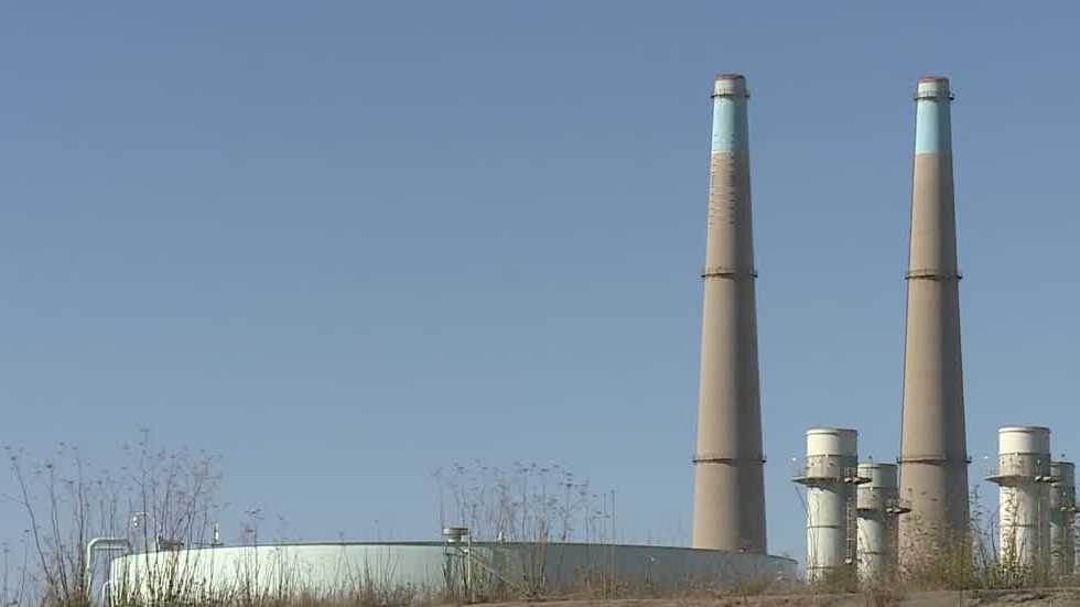

Now that it's dark, the fire is actually visible from the higher portion of our property. It's about 30 miles away. Yes, that big of a fire.
And yes, it's a *battery* fire. At a gas power plant, which -- I did not know -- also has batteries.
"construction of Phase 3 with another 350 MW / 1,400 MWh was underway to bring total capacity to 750 MW / 3,000 MWh, and commissioned in August 2023"
I didn't notice a fire this bad before but I found some reports of overheating/ involuntary shutdowns in recent years.
I am surprised that the power grid is still up. It's still burning, visible from Santa Cruz.
The grid has redundancy built in. One lost generator shouldn't effect the overall grid. Plus those battery plants are normally just peaker plants, to help shift solar power and cover the evening increase in usage.
