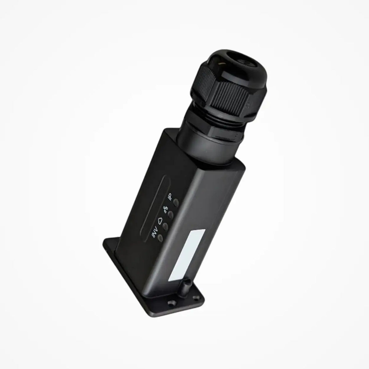

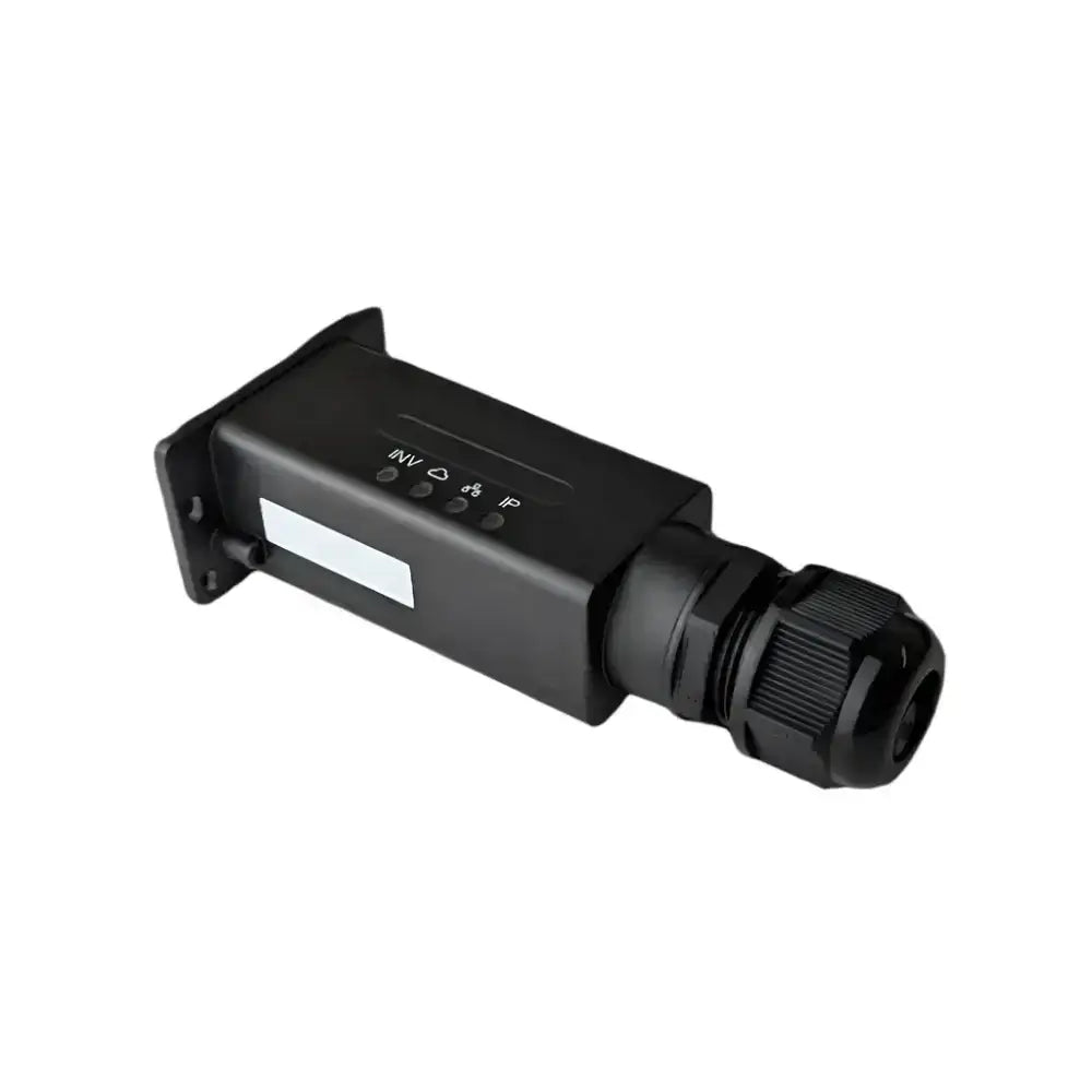

Are you using the meter 485B & 485A pinouts for communication? If so - does that allow you to use the dongle at the same time? I know using the INV485 wont let you use them both at the same time per the manual. Looking for clarity.
Yes, I am using the pinouts. Yes, using the pinouts you can keep using the wifi dongle. The INV485 RJ45 is the only one that is shared.
Yes! Thanks for the heads up, just swapped by FlexBoss21s over. Now it doesn't have the constant disconnect/reconnects it had over WIFI.
I ordered the ethernet version of the EG4 adapter (its super cheap right now for some reason?) so I can finally not have stupid WIFI networks and open bluetooth out there.
Just bought the ethernet adapter - much cheaper than the last time I looked.
Also waiting for my USB / RS485 adapter to show up (lost my good one somewhere in the electronics black hole).
Perhaps EG4/SS/CC should tell other retailers to stop fleecing customers :confused:
Do we really have to become the 51st state to get cheaper prices :unsure:
Lets see how long before they adjust the price.
Well, don't get too excited about the ethernet version of the dongle - so far the one I had installed lasts about 24 hours prior to going offline and needing a reset.
