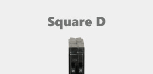

I plan on using this Box to mount the DC breakers for my RV Solar/Battery system. It's DIN rail mount in the back and should surface mount where ever you need it.

Still need strain relief.
Thermal trip only, not magnetic so no fast trip for large overloads. Takes a second or so to trip.
For AC, can handle short-circuit current of 200A? 1000A? Not sure the to different parameters.
DC, don't see the interrupt capability.
Probably good for AC from an inverter, which can't deliver much current anyway.
Maybe it is intended as part of equipment. Not good as a branch circuit breaker off the grid, those should have 10kA interrupting.
Should work for PV panels up to 50V, but not battery circuits.
Goes between 1500 watt inverter and 120VAC load.
At 10.5 amps the breaker can trip between 100 seconds and never.You would have to go out of your way to wire that in a manner such that 1500W inverter could overload the wire, even with a penny in the fuse box.
Based on the trip curve, that breaker is allowed to never trip at maximum output of the inverter. Won't necessarily do anything except act as a switch.
