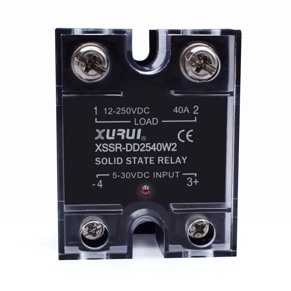

I have two PV arrays, each array by six 480w panels connected to solaredge inverter. I recently purchased two jackery 5000 plus. I would like to take one of the PV array to charge jackery 5000 via high volt pv input. Is there a way to use a relay or some switch that will allow me to switch between the two ie set it up from 8am -1pm to charge one jackery unit and then swtich from 1pm to charge the other? in essence looking for something that allows to switch between two different outputs.
Thank you. This is what I am thinking. Have two wifi switch to control power going to a 5dc charger. Then using DC SSR that is rated for 25AMP, 250 VDC and which can be trigger by a 5VDC. Use wifi switch to control power ie switch one on and the other off and vice versa.

One compilation is that all solar panels connected to a Solar Edge inverter will have Solar Edge Optimizers.
These Optimizers cut off all production unless they receive the keep alive signal from the inverter. Then at that point the inverter communicates the output voltage as the Optimizers are buck/boost converters used to hold the string at 370vdc (? from memory, that might it be the exact right number)
got it, so I may need to remove the optimizer from this string. The other string I will keep optimizer that will be connected to solar edge.
To further complicate things, Solar Edge also has a minimum string length to get the optimizer output voltage and entire string voltage high enough. Six is probably about the minimum for any Solar Edge system. But they do publish spec sheets that will show what your Optimizers and inverter require as a minimum string.
Nevermind, I miss read your post. I thought you were talking about splitting your one string and leaving some on the inverter. But you've got multiple strings and you're looking to pull and entire string away from the Solar Edge. If so, all my above info doesn't apply
