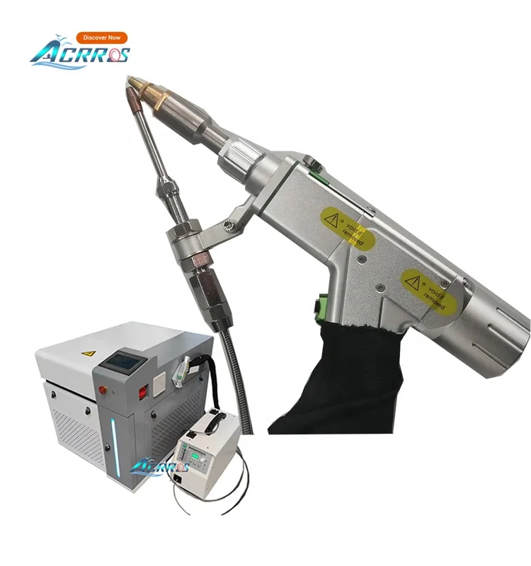

You rock Bananaman.
Odds of finding a laser welder here in my area are not good at all.
Go talk to your local jewelers. Many of the higher-end-non-franchise shops will either have or have info on whoever does their laser welding repairs.
As to who buys those cells? Those are probably 2nd grade from the same people who make Chins/LiTime/PowerQueen/Djwkrp/etc that weld their stuff together inside.

$5,700 buys a whole lot of batteries WITH terminals.
This is likely not enough power to make the weld fast enough to prevent overheating the battery terminal.
This needs to be done by a robotic welder to get consistent results as any inconsistencies will likely effect resistance, balance, degradation, ect.
Please be reasonable. 🤔
But think of all the chicks you will get when you can weld you own terminals 💃
If Will ever comes out with a line of merchandise there needs to be a shirt that says, "I weld my own terminals."
