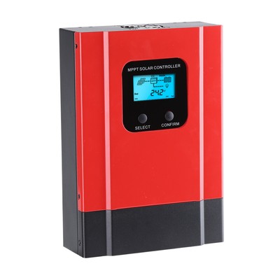

Trying to destory my SCC's: I can't do it!
So I took every EPEver/Victron/PWM/Renogy solar charge controller, and tried to fry it by connecting it only to solar panels, and not to a battery... guess which one survived?
EVERY SINGLE ONE! I couldn't destroy any of them, and I left them connected to a high voltage array (80 volts) for 4+ hours each.
I connected each one to a lifepo4 bank after the test, and they functioned perfectly. Tested output with a watt meter before and after as well, no change.
I read in the manuals that you must NEVER connect an SCC to an array without connecting it to a battery first, because the potential that it can fry. I know that having improper gauge wires on an SCC can cause overheating around the terminals (dedicated voltage sensing leads would probably fix this problem, but many SCC use the charging lines as voltage sensing, which makes it wise to over gauge them most times. The voltage drop of a long run of hot wire can be horrible). But to actually connect an array to an SCC, and not to a battery, in my experiments, no issue.
I am thinking that the feedback signal in the converter circuit needs a reference voltage at the output to work. Then it can track the power point between the panels resistance and internal resistance of the battery, then push current to the max. If you only have the input powered up but no current is flowing, what would it stress? The panel would be in an open circuit voltage, and possibly use some power to charge up caps on that side of the circuit, but thats about it. Should be fine to leave connected.
Am I wrong? I know some MPPT's circuit designs are pretty complex, but they are still a simple converter circuit with inductor and capacitor and basic logic system to modulate it. I know some current limited converters can handle amp sources at input/output, and others can't. but because the solar panel is open circuit in this instance, and the output is also voltage sensing of the battery, I don't think any damage can occur.
What do you guys think? How can I destroy one?

I have a bit of hands on experience here from back in the day when I used Morningstar and EPever MPPT SCCs - the scenario that destroys the SCC is not so much applying PV without battery connected first, rather, a sure fire way to destroy a Morningstar SCC is to disconnect the SCC from battery when the PV array is producing power at or close to the 'maximum clamp current' of the SCC - the Morningstar and Epevers have a maximum short circuit current they can tolerate - disconnect the battery while the PV array is able to produce more than this short circuit current and you will release the magic smoke.
I have had this happen twice with Morningstar TS MPPT 60A SCCs and the one Epever 60a (Etracer BND series) - I can confirm that the Victron SCCs do not suffer this flaw.
The risk of SCC destruction is higher when the PV array is oversized relative to the SCC's max short circuit current rating - so in my case, I had a 4500w array connected to the Morningstar CC with rated 60A max current - accidentally flipped the battery disconnect breaker while performing inspection/maintenance on a bright sunny afternoon (CC was making about 58Amps at 59v) and the SCC blew up immediately with a loud bang and some fire.
I stopped using DC breakers as battery disconnect after that first incident.
I since switched to Victron as I needed a compatible SCC for my Pylontech US2000s - Morningstar offered a lot of cautionary statements around battery disconnects and did not offer native support for Pylontechs or other Lithium brands at that time.
To be clear, you need to test the SCC for this failure mode by disconnecting the SCC from battery while the SCC is in operation and producing power at the max rated battery current (current limiting the PV array) and connected to an oversized PV array e.g. one that can make 90A while the CC is rated for 60A and clamping the solar current to within the SCC tolerance.

I've be using and installing Morningstar Controllers since the late 90's....
Over the years I've had EVERY one fail... They all sit on my 'Wall of Shame' .
The usual response from Morningstar Customer Service was 'damaged due to lightning'.....
Thru the years we've replaced all those controllers with Midnite 150's, or on the smaller systems Victron SSC's.
None have failed.....
I definitely agree with NeeYee... Maybe the next round of testing should include disconnecting the battery, while the SSC is actually charging.....
This will be the failure mode when the BMS disconnects the battery pack, after detecting an over voltage run-away cell.....
This is now a common problem case..... It would be interesting to see who passes and who fails......

I've seen pwm controller output voltage rise to the panel open circuit voltage when the battery is disconnected. In a 12V system, that would be about 22V.
Another destructive source comes from the fact electrons want to keep flowing when the circuit is opened at the battery. The moment the circuit is opened, inductance in the circuit generates a voltage spike. The greater the current, or the inductance (length of cable), the greater the voltage spike. The spike can get large enough to take out other electronics. Often power relay contacts get pitted and fail. This is due to the generated voltage spike which induces a spark across the contacts as they open. The spark burns the contacts.
The voltage spike may not take out the SCC, but it could destroy sensitive electronics that are still connected to the buss.

I have a blown EPEver 6415AN
Only in service a few months. The battery did get fully discharged several times during overcast days.
Now, one of these overcast events (that lasted several days) the SCC died.
Was it from the battery/BMS disconnecting at night, and the sun hitting it in the morning with battery missing? I dunno, but that's what I assumed.
I tore it apart (after getting no support reply from EPEver) checked all the mosfets, fuse, and diodes. All fine, no shorts.
I pretty much traced it back to the micro controller board being dead.
What happens if my battery's BMS kicks in protection due to overvoltage, or any other reason? Is this the same as the SCC being disconnected from a battery?
