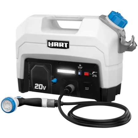

I bought a couple of these on clearance:
My plan was to use them for emergency shower, take to the beach, or water container plants without hose dragging. Could work, but not insulated.
