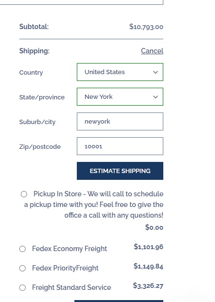

OMG...I just went into the SignatureSolar website and placed the inverter, 3 batteries, rack and a DC cable in the cart and the shipping is over $2550. No way I'm paying that much for shipping.
You can ship a car from Texas to NY for $850. Could their shipping calculator be broken?

Well, the low frequency inverters do weight a bunch more, and freight is tied to weight and distance. Is watts247 closer to you or something?

Yeah that's not right...3rd party freight app was offline briefly for 15 minutes this morning and could be related to your issue. Check back soon, we are looking into it currently.
Edit- Looked into it and indeed freight quotes are atrocious for New York right now but are better than this morning, and may be related to the recent congestion tax/toll. Just for full transparency, we do not control shipping prices, they come straight from the carriers.

I spoke with Dustin and he was able to confirm that the shipping calculator on the website wasn't accurate. After providing my address, he came back with a shipping cost of $645 which is much more reasonable.
