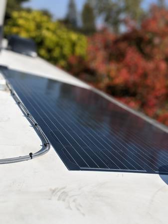

I was thinking, have you explored the "peel & stick" panels? I was thinking you could potentially get a lot of your power from this type of panel and maybe reduce the size of the other larger panels. Just a thought :)
