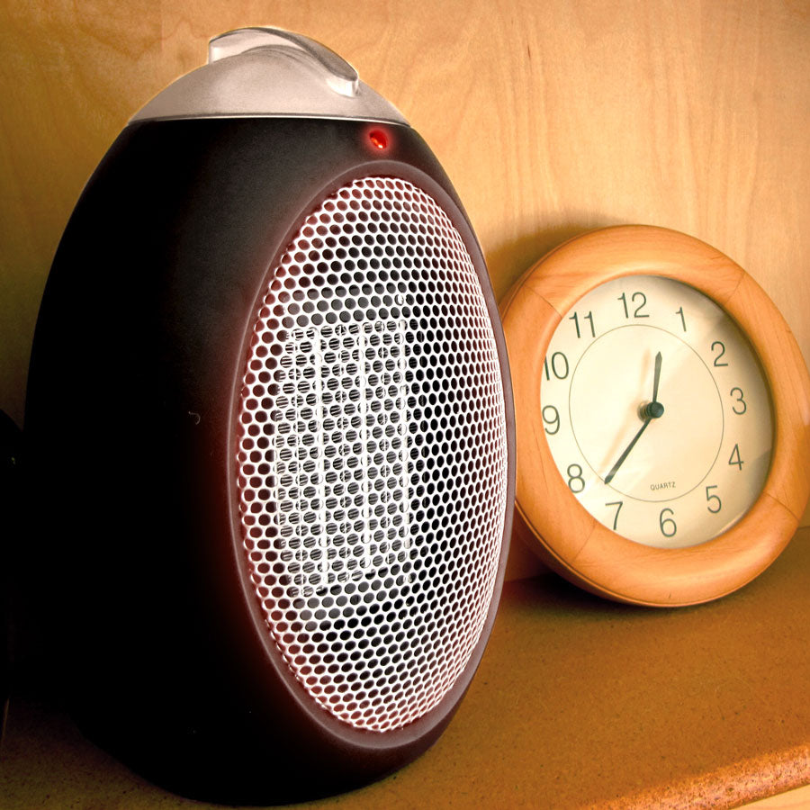

My wife has a space heater she uses under her desk (even in the summer). I've convinced her to switch to a hydronic heater to reduce energy costs.
That space heater is 1800w. Not that it runs all day, but it could be on for 4-8 hours a day. Even longer in the winter.
A portable oil filled radiant heater may be a better choice on low.
Heat is heat though. If you are putting in less BTU, it won't be as warm. You use less energy only if you have a way to make more BTU for less kWh. Source: living in freezing climate for a lifetime.
This is why I believe it's much easier to skip things like BTU, and just use kWh: 1 kWh of electricity == 1kWh of heat, especially since electric heating elements are 100% efficient. Heat pump with CoP of 4 -> 1 kWh of electricity == 4 kWh of heat. You could go all the way with Joules, but the kWh is easier since we start with electricity as an input and don't care about yet another conversion.
There are still ways to get the home office to be more efficient. You could close a door to it, or otherwise separate it from the rest of the living area. That way there will be less heat required in that area for the 8 hours its in use. It wouldn't be drifting to other parts of the house quite as fast. Setting up in a smaller room will also require less heat to make it comfortable. If you really want to be an energy miser layering on the clothes helps a lot if you are cold.
I don't intend to be negative about another heater choice, but I did want to point out that a different type of straight electric heat is usually not an end all solution.
Have you considered a personal heater, foot warmer or heating mat, like the Cozy Legs or Cozy Toes?
