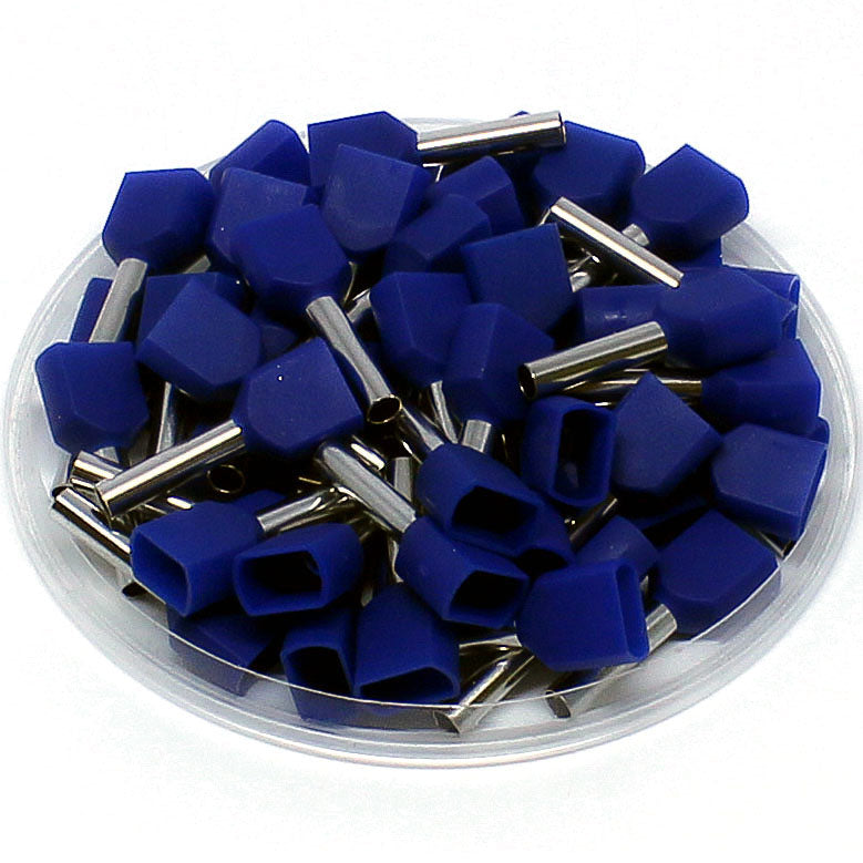

The Blue wire is 120V for the Gen trickle charger. This can be connected to either L1 or L2 of the same Smart Port. I would suggest getting something like this double Ferrule.
Hopefully the smallest breaker that fits the Smart Port will have a screw terminal compatible with the ferrule diameter. I would think an inline fuse would be a good idea on all 3. Although the Generac manual only calls for a fuse on the blue charger wire.
