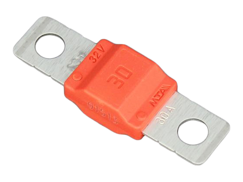

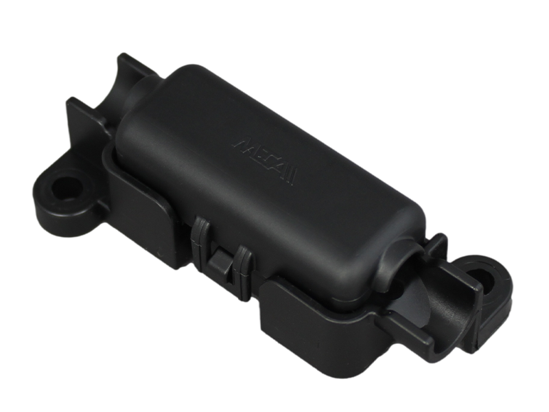

Controller outputs to battery, in line fuse as close as possible to battery positive, 30A. Use this,
In this holder

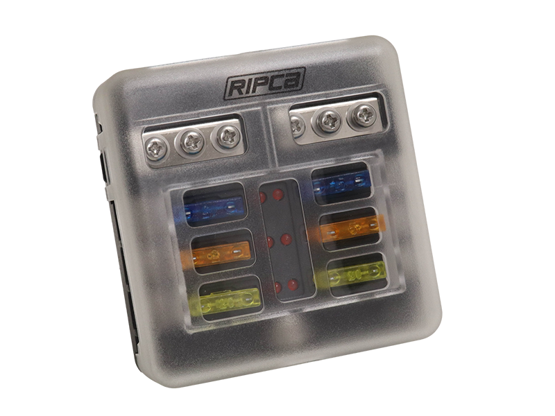

To feed the acessories use a fuse box like, 6 or 12 way,
On this fuse box, the top stud is negative, connects to battery negative, the bottom stud connects to battery positive via a fuse 30A ( the same type as used for the controller).
In your fuse box use a 10A fuse for the pump and 5 amp fuse for each light.
