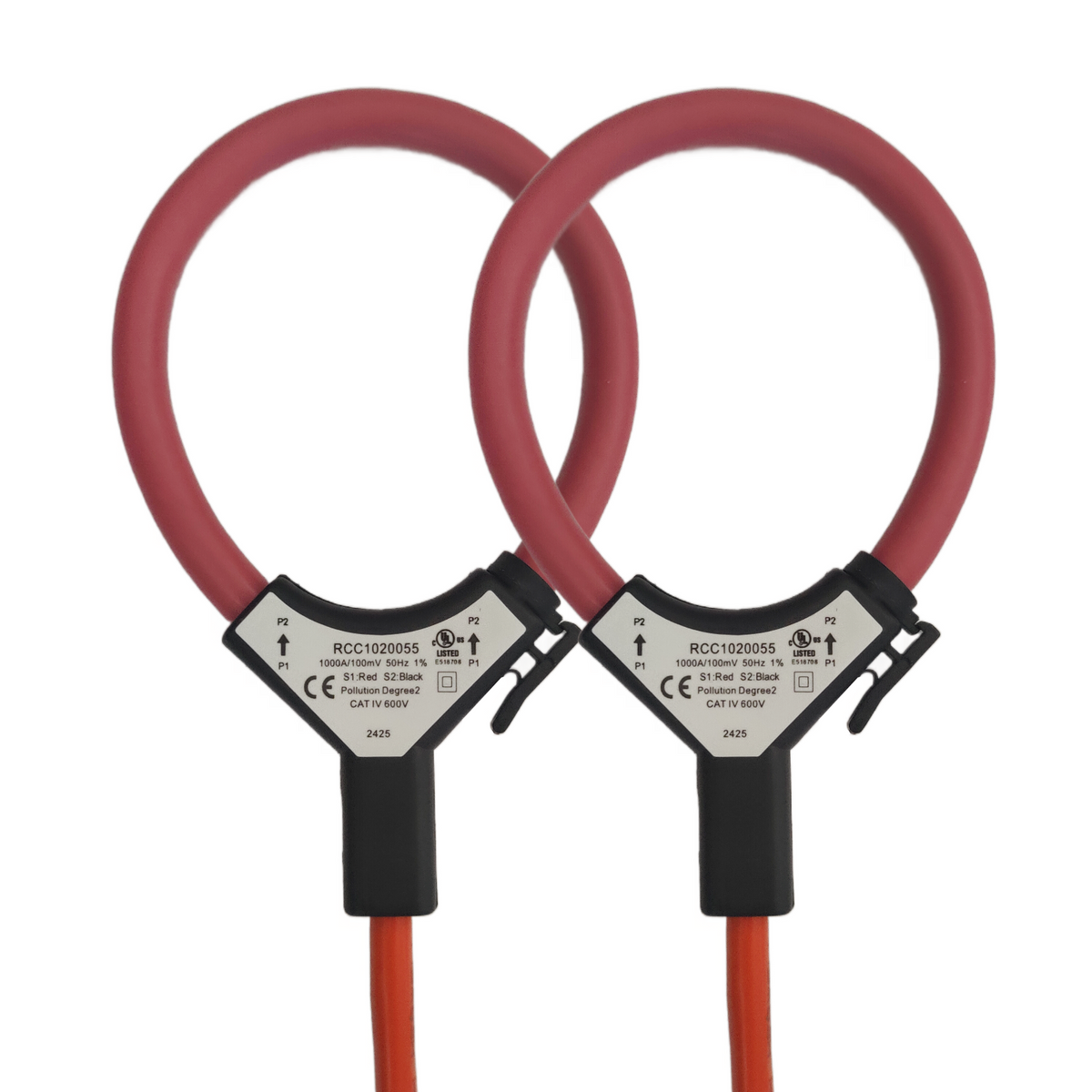

I'm in the USA, with a normal 100A split-phase home main panel, which is pretty full.
Would an Emporia Vue Gen 3 (16 sensors) fit?
My biggest concern is the two main sensors, which don't have much room around them, but squeezing in the other sensors looks difficult.
What do you think?
Doesn't look like it. You might measure (carefully) the width and depth to the right of the breakers. Hard to get an idea from the image.
There's also smaller units like Shelly, but I think they only do a couple of circuits.
Do you think the problem is more with the main sensors, or with the branch circuit sensors?
I notice that the Vue 3 now has flexible main sensors which might help?
