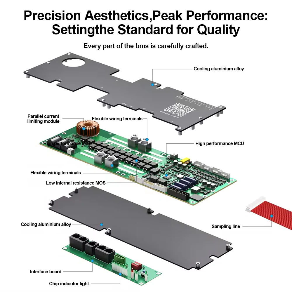

JK BMS versions 15 and 19 have coulomb meters (current shunt resistors).
Hoo did not know
But where is it ? Where did you get this information that jkbms 15 and 19 included a shunt, can't find it...
Maybe @RCinFLA can answer that.
Well .. that's exacxtly my point, since it give innacurate information, this can't be called a shunt. You could also call a car an excavator cause you can put dirt in it .. but still .. it's not it purpose or let's say it can't be used that way.
