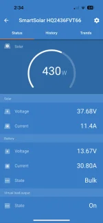

My initial test was not in optimal condition, early February in late afternoon (1430 hours); however, the panel output was still impressive. The output at the panel was 47.4V and 11.6A. With slight loss through the extension wire, the charge control was recording 37.6V, 11.4A and 430W. I wanted to get a record in actual conditions, not just optimal setup.
Voltage Output Amp Output Charge Control V & A

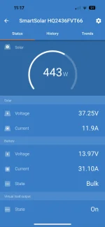

I did get time several days later to record the output in better sun conditions. This test was taken at 1115 hours. The output at the charge control was 37.3V, 11.9A and 443W. This is impressive coming from 450W rated portable panels.
Panel Setup Second Test Panel Specs Second Test V & A
