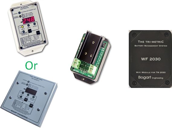

The uppper right section is a bogart engineering kit. The white box is their Trimetic monitor for SOC and more advanced features ( only partially wired right now )
Directly under the monitor is the PWM solar controller, which is great for this because of the solar panel position - it started to produce power at 6 am this morning but only gets power part of the day.
Just to the left of the solar controller is the WiFi module. This transmits the info and allows very easy programming via any device with WiFi and no additional software or applications to install.
To the right is the shunt that comes in the kit.
This is the Bogart kit just to make it easy to find. I have no affiliation other than just being a customer.
