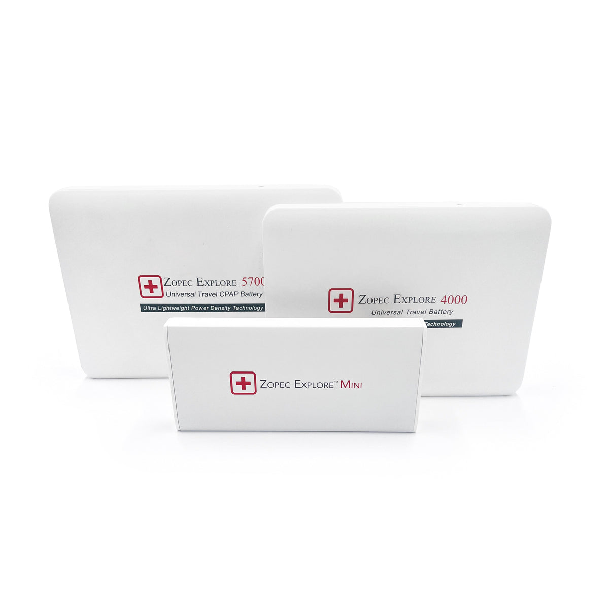

Expensive because they are medical grade:
