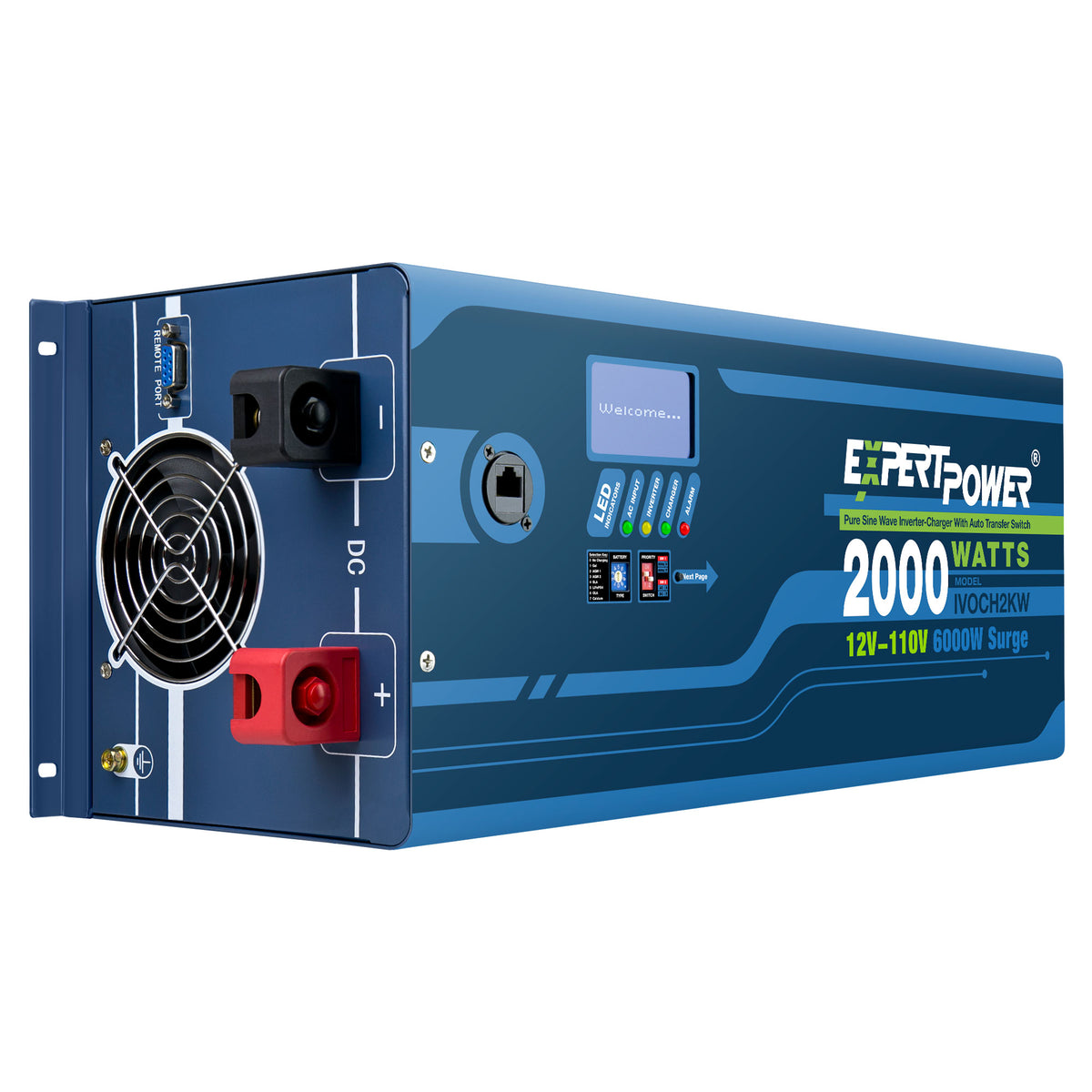

What specific inverter do you have? I was planning to use an automatic transfer switch to feed the converter/charger from either the inverter or shore power. But it sounds like your inverter has an integrated transfer switch?
It's the Renogy 3000w take a look on YouTube. It has a 'pass through' facility which negates the need for an ATS
You must have the inverter/charger. I just have the inverter, which does not have AC input for pass through.
Def NOT inverter charger ?
the US version only seems to be in the 2000w version for some reason?
if its what you need, is it worth trying to sell your current inverter and buying the pass through version? i assume the same thing is available in the US and as you mentioned, can you send the new unused inverter back in exchange?
I don't need the inverter AC pass through as I already have an automatic transfer switch.
