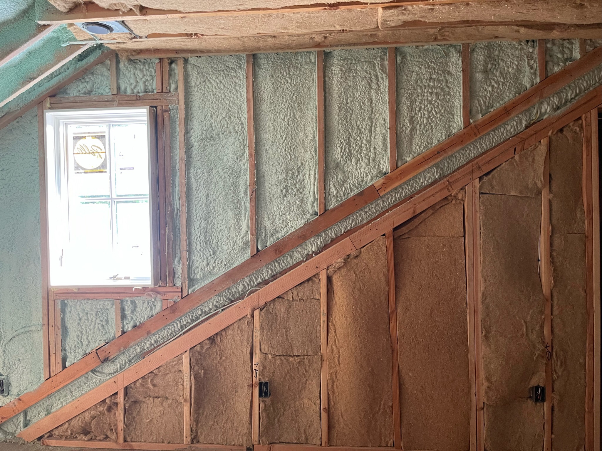

This is stated only = Second passive home built in the whole of SouthEast...... Took 2 years to build it so you know the high cost makes it unobtainable for mass home building. That darn ROI. How long has man kind been on this planet? We are still retarded. I am being serious. We are dumb asf.... if I was an alien arriving here would think cock roaches are smartest beings on planet. We been here all this time and still don`t know how to build a home. Centuries upon centuries. The Roman's roads buildings sewers still exist... we are retards.
These passive homes reportedly cost 3-5% more to build but they save 70-80% for heat - cooling.
These passive homes are so air tight that fresh air has to be brought in and bad air taken out. A fart would linger. Imagine cooking fish and smell never leaving. Me thinks we should go back to caves. Mongo.
The spray foam type encapsulated building construction means the wood can not be inspected for pest aka termites
Roofing done with standard shingles is a no go too. They asphalt shingles get to hot and self destruct. So have to use different roofing.
So we can cancel Christmas on spray foam. ...other reason not so many passive homes. Read link.
It takes more then just ac. So do we destroy our current homes and build new passive homes back in there place. The spray foam is a future negative. Again we must be retards. How long have we been here.... centuries... we are dumb asf. But we never admit. I have grown more retarded everyday.. I feel am not the only one. How did we get here without all the tech that we have now?
