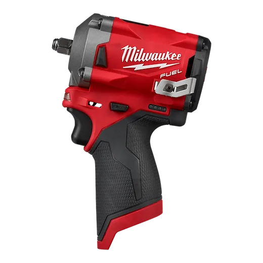

When this impact released there was nothing like it, high torque for the compact size. This is why I made the swap, now there is plenty of competion, but I still like it.
I like it too. I've got an m18 collecting dust because this m12 has the same torque AND it gets in tight spots.. I use it almost every day at work. Think I'll check cell voltages for fun. Thanks for the post.
