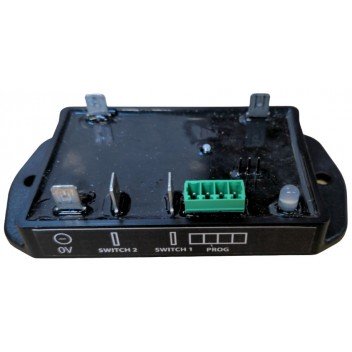

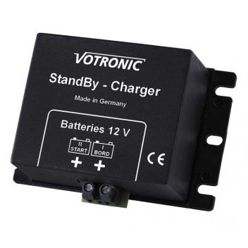

Buy and install to maintain the starter battery,
Or a more advanced unit,

£40 is pretty reasonable for that votronic but still, having to install something, seems overboard for this if there is a simpler solution.
